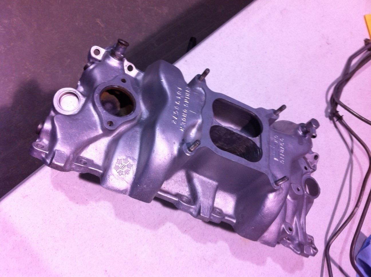

Heres a Z28 Intake I had Vapour blasted today, I like that it still retains the GM silvery finish and the Winters logo and part numbers are nice and crisp. I think it came out pretty decent, considering it was a old extremely dirty example. Sorry no before pictures, thought I took 1 but forgot.

Looks good Mike. I was going to take one up to Don's and see how it compared but Todd was quick to tumble both of them before I could pull one back. I think both methods look good. I would like to see them side x side in the same lighting.

Actually I didn’t take this to Don, a friend was by the shop and he made his own vapor blaster out of a small modified glass beader cabinet , with #13 slurry and pressurized liquid. We actually only spent about 6-8 mins on this 1, it’s for a 77 Z motor I put together for a friend, it had been on the car since late 70,s and the car sat for about 25 yrs outside and was super water coorroded and stained & scudsy even after soaking it in my 5 gallon pail of carb cleaner, and pressure washing it off. I didn’t want to glass bead it , but really didn’t like the finish, so I decided to give it a try. Super pleased with how it turned out, I think Don has a commercial machine, and the finish & quality would be even better.
