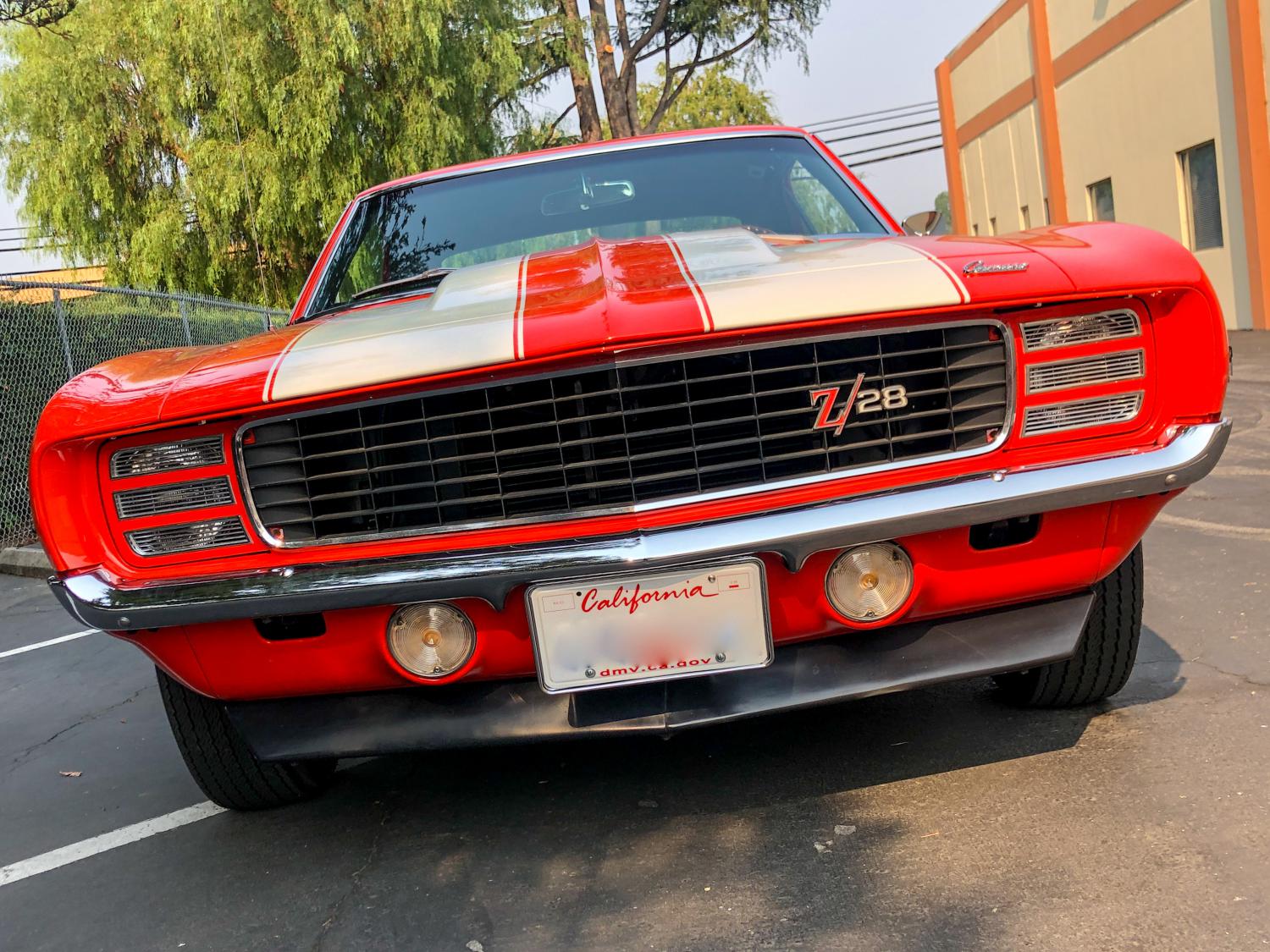

Gratuitous front end shot to accompany those little fixes that weren’t particularly visually interesting...
