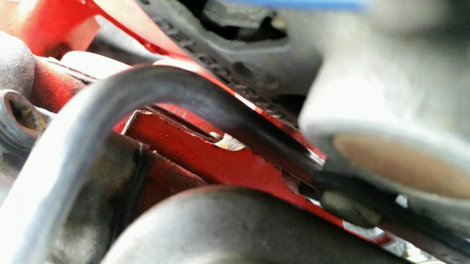

Pretty sure you got a real z/28
If you show the wheel codes on the bottom of that build sheet, that would really nail it.
They are just out of the picture at the bottom.
I can see the 55 paint code and it has posi axle.
YF front coils are z/28
UH Radiator is Z/28
Rear Springs BM
Looking good so far

Engine UPC G - nails it as a Z28.

Thats correct on the engine. Im pretty sure the spoilers and ZL2 hood were added also. This z/28 doesnt have alot of options. No tach, no console or gauges.
Would look great in its original Azure Turquoise paint.

If that is the original engine as stated, like William said, if that pad could be cleaned off for a really good look at the stamps, and verified as real/untampered, that would pretty much put the nail in it for me as a real Z/28, and worth while correcting other stuff if the price is right.

I was back and forth with the owner, but too much money (especially once you exchange into Canuck bucks). Automatic trans radiator, wrong distributor, but correct carb and alternator. Originally a flat hood car. The original interior and panels were quite attractive for me, it's a very clean car. Definitely a Z. Where on the buildsheet would the VE3 be called out? Or would it?
