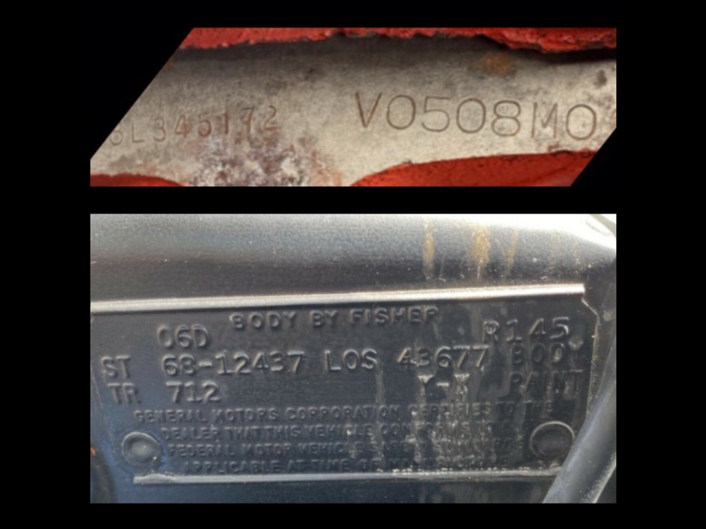

I don’t see pics of the wheel codes? I know as says dated 15x6 wheels, but those wheels look like they have too much dish to be DF’s and also look like they’re running 15x7 style trim rings. Looks pretty honest otherwise, and a NW car to boot.

Maybe not a big deal to some but worth mentioning, spoilers were not available when the car was ordered with rear antenna. This car has an AM/FM in the dash but rear antenna was AM radio only. I agree the wheels don't appear to be DFs based on the look of the offset.

Nice car but why replace the cagenuts that secure the inner fenders to the fenders if it's a survivor. Pic is crappy but they look like round type instead of square.

Nice plated Steering arm nut- I seem to remember some debate (.crg) about that.

How is a car a “true survivor” (as the seller calls it), if it has been repainted?

I really like the looks of this car in Yellow with the factory tinted glass. Sits perfect with the bigger tires Looking at it straight on from the front the drivers side headlamp and trim looks to fit really poorly, odd shape to the fender in that area? Fit and alignment of the bumper looks off? I don't know............still looks to be a great car or certainly can be great car with some work.

Looks like a great car w/ lots to like also a few thing to improve upon.
Subject VIN 124378L345172
Delivering Dealer would be Lew Williams Chevrolet Sacramento CA as info below, not Lou as noted also not Lew Williams Chevy operations of Corpus Christi TX or Eugene OR.
