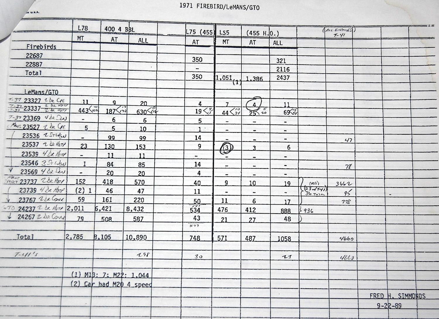

If it came with the T41 nose, it came with the hood scoops a la GTO.
EDIT: Chart may not pertain to your car.

Originally Posted by ssl78 View Post
According to your chart there were only 102 Lemans with 400 4 speed is that correct?
The body code shows xx67, so that's convertible. And the transmission column where 102 lies is for all manual trannys, so that's 3-speed and both 4-speeds.

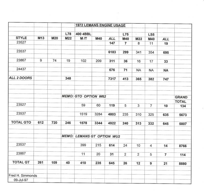

The car also has buidsheet and PHS. Do we know how many 1972 Lemans coupes had L78 400 with a 4 speed

Right, which means the numbers you asked about don't pertain to your car.
I'm guessing the numbers currently are MIA. I've seen a lot of the docs at the GM Heritage Center and a lot is missing though, admittedly, the info I've scored is disorganized so I'll have to take a deeper dive later to confirm.
Here's what 1971 numbers look like.
