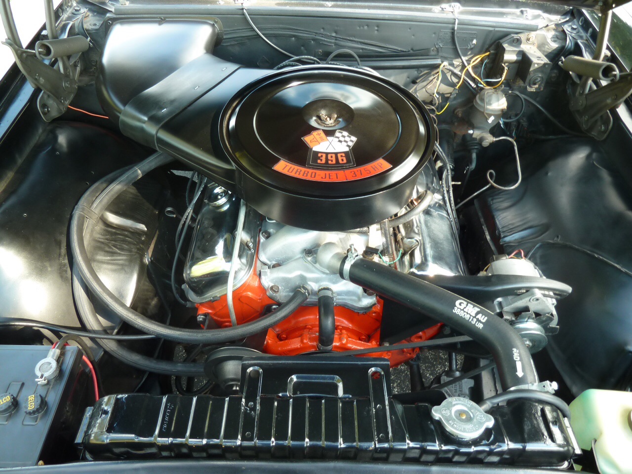

The Chevelle unit and Camaro unit both use the same A226CW filter. The cowl plenum shown in your post at the top of this page appears to be a repro which uses the more commonly available 17" diameter lid. It has a rubber seal in the outer groove whereas the real cowl plenum lid is 16-3/4" in diameter and does not have a rubber strip for sealing to the base. The "697' filter will fit with the larger diameter lid because it was designed to use that filter in the first place. The larger diameter lid is used for the repro because it looks close enough that most people don't catch it, uses a commonly available filter, and means there is one less piece to have to tool up to get made.

Originally Posted by bluel78 View Post
I tried Heartbeat's and it's the same as the parts stores AC Delco A697C 8997189. It's roughly 7/16 too tall. Didn't take it back and couldn't locate anything that would work so cut it down and used windshield urethane to bond the rubber seal down to the element. Actually works and looks good but rather spend an hour elsewhere.
Yes- Correct
I "JUST" tried a New ACDELCO A697X in My NKR Camaro CP (Cowl Plenum) unit with a 16-3/4" diameter lid without any rubber gasket designed and the New filter was to tall. (Bummer)
NKR supplied a WIX 46948R with a rubber compression tube glued to the bottom.
https://www.amazon.com/Wix-46948R-Ai.../dp/B00LFVWPGU
JIM
69 Los Z11
68 SS/RS 396/325
68 Los Z28
