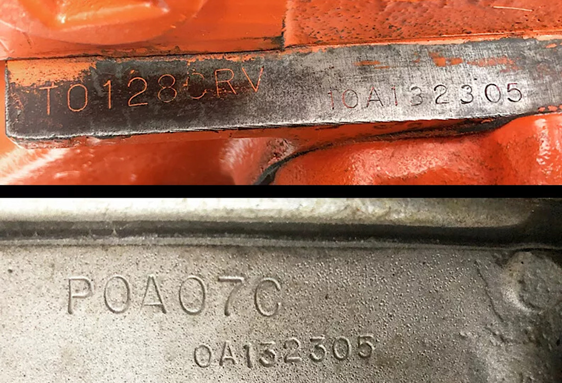

Build sheet looks to be fake IMO. Trans stamp? I don't think so, and at least the vin portion of the engine stamp doesn't look good either.

Craigslist car is 136370A132305
Sold @ $75,000 Leake Scottsdale 01/2020 Lot 443
High Bid/No sale @ $95,000 Mecum Glendale 03/2020 Lot S136
No sale on eBay @ $ 125,000 04/2020...

Relisted at $119.5 and that has ended too. No match between engine and tranny stamps!!

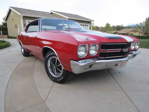

The red one shown in the Phoenix Craigslist ad is being marketed by Northwest House of Hardtops in Portland OR.....immediate red flag.
