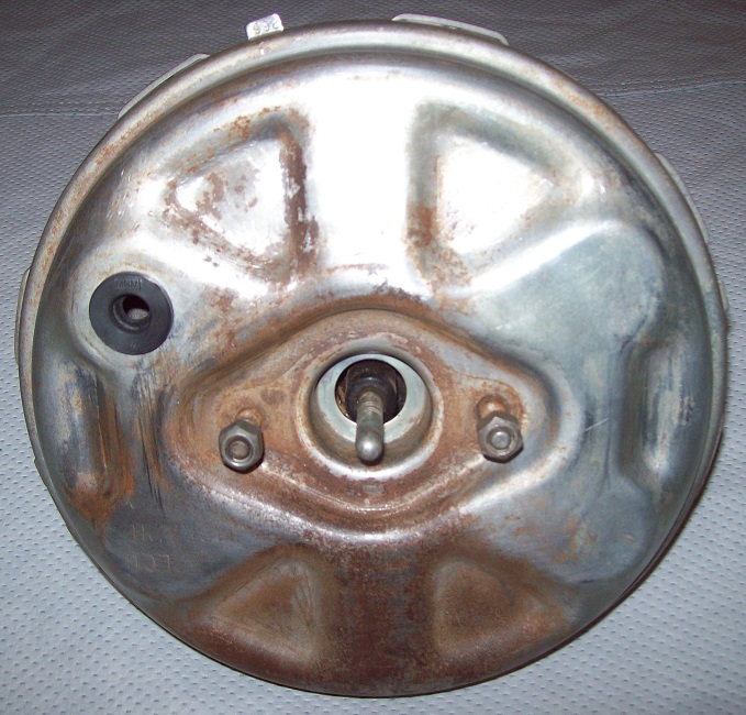

I am aware of the Delco Morraine (sp?) stamp being upside down on the passenger side of the booster on the originals. Guessing there are some other tells.
Not true at all, I have taken many of these off original cars and found there are 3 Variations, Upside down Left Bottom, Right side up Right Top and NO Delco Moraine Stamp at all. Just speaking for 1970 Chevelle though as I have had many of these.
Here is a photo of one I have for sale in the Classifieds that Helmut is buying to just throw in an example of the most typical BW Born With Unit

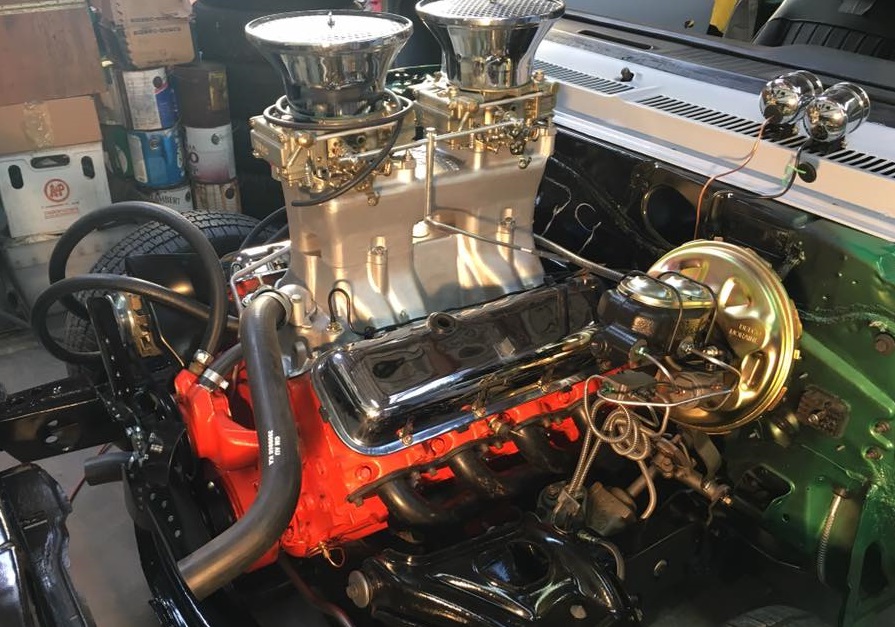

Here's one....

I actually don’t mind these repops...for the price they look decent and work well. Way better than the typical parts store booster that looks like it belongs on an ‘87 Buick Century.

I agree!! We donated the pristine original to a high quality concourse resto effort, and installed a repop - I want Ben to drive the wheels off this thing!! To be honest, I thought the repop look pretty good.
One thing to know is a little tip from Jed P here in PA, the receptacle on the face of the booster is too long - probably for multiple applications, and thus it effectively maintains constant brake pressure. This is a small bakelite type of item, and it must be ground flush to prevent the brakes from overheating....
