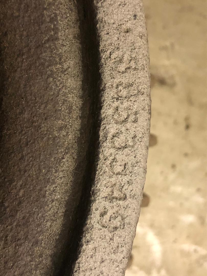

Also - front drums that were installed for racing are 1969 part numbers. So, discs must have been replaced early on - when car was raced. Unfortunately, Whelen foundry apparently didn't put date codes on their drums. I thought that it was an MVSS requirement back then, but all that I can see is the part number and insert number.

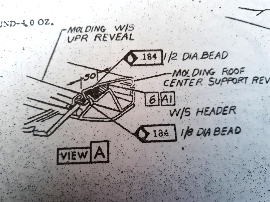

Something that most people may not realize... the upper area below the header trim where the rear view mirror attaches is untrimmed and exoposed metal, IT WAS sprayed with dash texture.
Also make sure to use the foil tape over the convertible pinch weld so when the clips push on they do not scratch the paint and cause areas of bare metal to be exposed and ultimately have rust come out from the trim.
Sealing the header trim also must be done correctly in order to keep water from being driven over the edge of the header and a waterfall into your lap!!!... the early C3 Corvette Assembly manuals illustrate the sealing method.

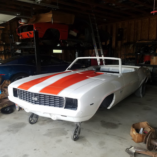

slow progress on ownership history. Now back to circa 1975. Still checking with 1969 employees of Forest Chevrolet. It was the only Pace Car that they sold & customer ordered, so maybe someone knows the OO.
This pic was sent to me by the owner who bought it in 1977 in Manchester, Maine. He still lives in Scarborough, Maine today.
