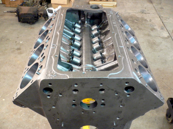

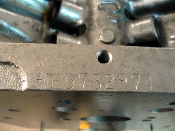

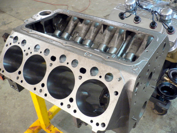

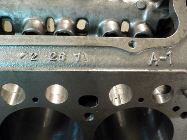

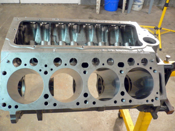

I built a couple 392 Hemi's a few years ago and had the blocks shot blasted and they came out looking like new, the factory number stamps remained unaffected.
The lifter valley looks a little shiny as it was slightly smoothed before blasting.

I have a block (bbc) that has had the lifter valley that appears to have been shot peened. I can only assume it was to aid in oil drain back? The texture is smoother than the rest of the cast surfaces. If it had not been for my penchant to test fit everything before assembly, I would not have caught that the peening had distorted the tops of each lifter hole preventing lifter installing. Deburring corrected this. But be aware that distortions are possible.
On another bb I have that was rusty, the shop put it in a blast cabinet with a caustic soda rinse. Now, you have to use a magnifying glass to read the pad. Guess the shop screwed that one up? So, be careful. I like the magnet idea On the pad mentioned

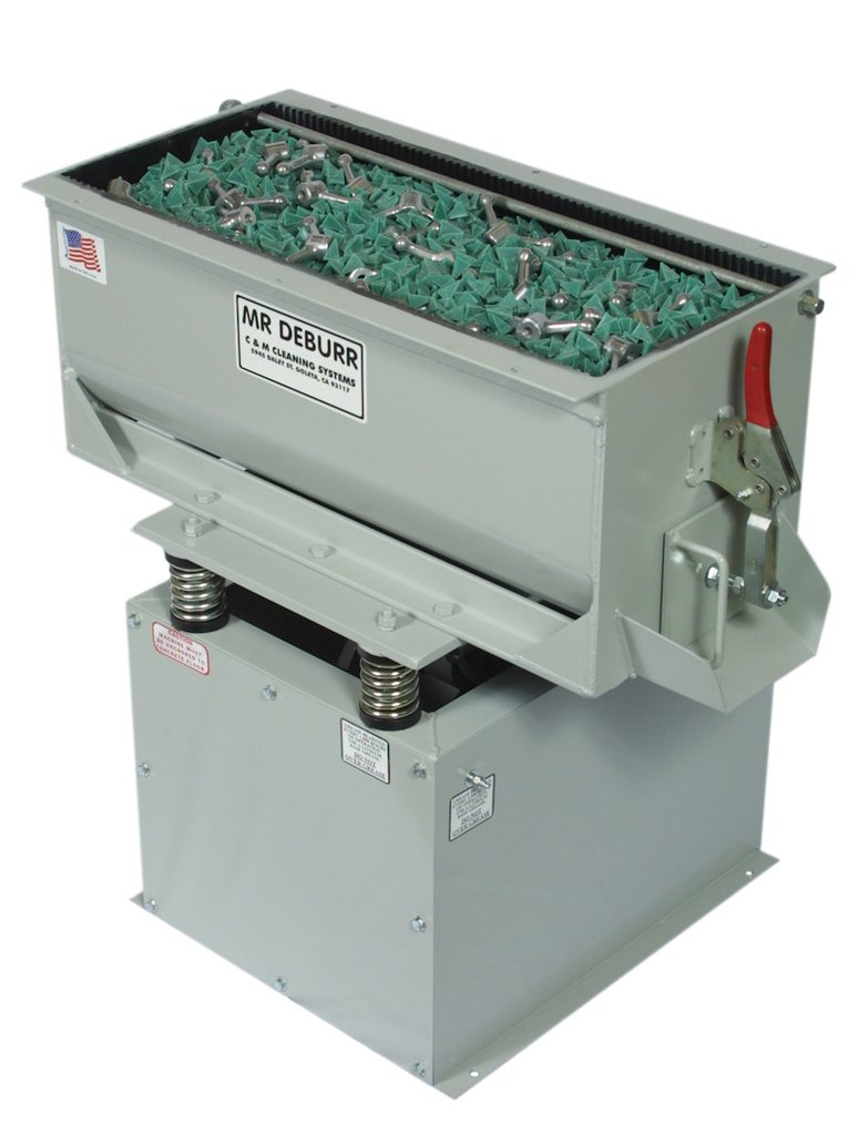

Rick, In another thread you, I and others were discussing cleaning parts in general.
Ive had all kinds of the other chassis parts, eng brkts etc etc....run through a local
shot blasting machine. What with all the massive shop time you charge customers
to stand in front of your slow glass beading machine, you need to take most of your other steel parts to the shot blaster assuming the cost is acceptable.
My shot blast guy also has a enclosed basket that I place fasteners into and then
shot blast. Ready to replate or you could quickly run thru your glass beader
Ive also bought a used MrDeBur shaker/vibrator which is another option to clean
restore metal finishes.

Rick....You had earlier stated " We spend hours a day at the glass bead cabinet for things like spindles, steering arms, brackets, clips, etc and it is a complete waste of time when I could be having a machine do it automatically for me while we do something more constructive. The expense does not really bother me as that could be paid for in less than a week in saved production time alone."
I certainly didnt mean to imply you were overcharging anybody. I was suggesting that shot blasting and vibratory tumbling/shaking would cut down on your labor hours and increase your shop productivity.
