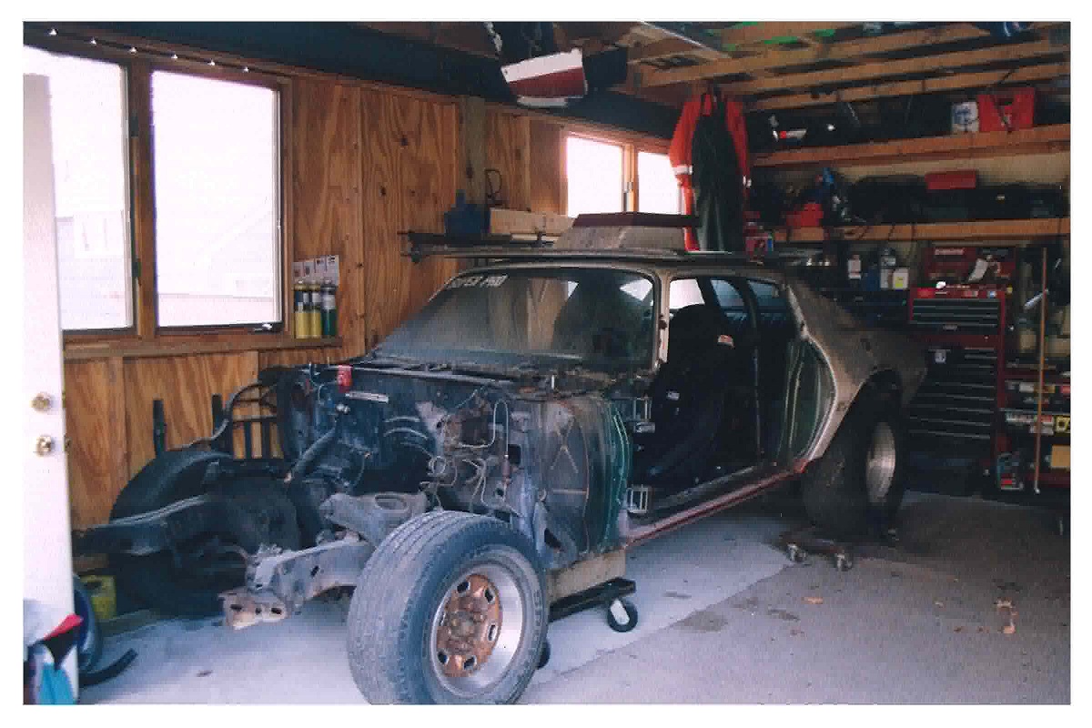

Thanks for the compliments Mark. I bought the car in 2004 where it had been a dedicated race car since 1973...not much left when I got it, but the shell sheet metal was really solid...but the front end/decklid were fiberglass and the doors had been cored-out. the LT1 was long gone as was the original Muncie, but the original COO rear is still there.
https://www.yenko.net/forum/attachmen...1&d=1505234984
Soooo....how are you progressing on your L-78?
