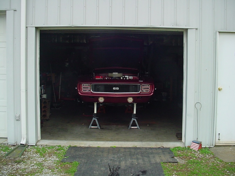

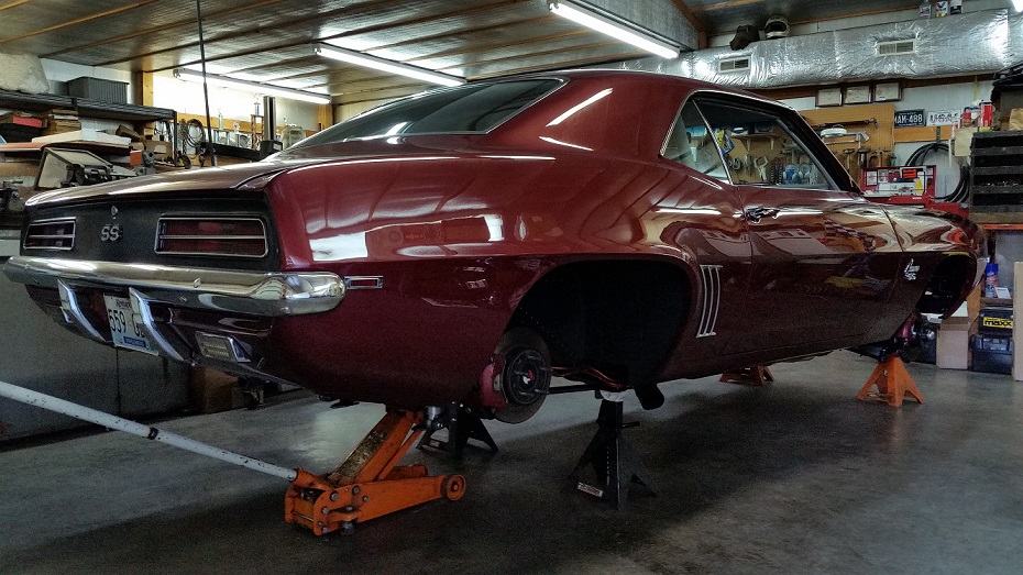

I just thought that this first picture was kind of cool. This is when I was redoing the rear suspension. The next picture was when it was waiting on it's 4th set of rear tires. I started with Mickey Thompson 31/18.50 Sportsmans, then went with Hoosier Quick Times, then Pro Trac 445s and now it has Hooser 31/18.50 street radials.

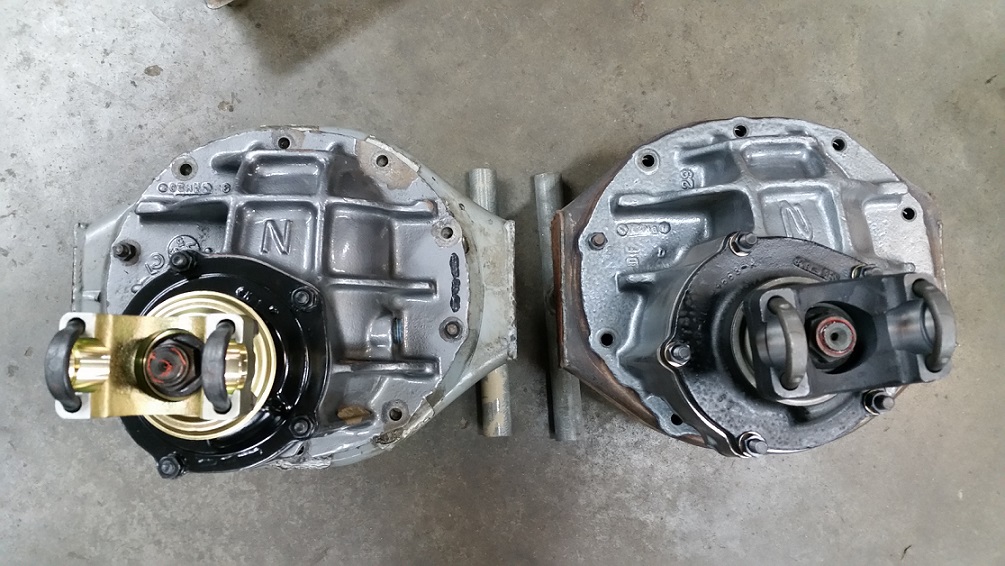

In the last few months I've built a new M23 Auto Gear transmission with the 2.99 first gear http://www.hotrodders.com/forum/auto...ld-468129.html and got a new McLeod dual disc clutch. I also built 2 new chunks for the rear end. The one on the left is the street set up with a small bearing nodular case, Daytona pinion housing, 1350 yoke, Detroit Locker and 3.70 gears. The one on the right is a the race set up with a big bearing nodular case, Daytona pinion housing, 1350 yoke, spool and 4.86 gears. I also had a new 4130 drive shaft built by Strange Engineering with 1350 u joints and a 4130 yoke.

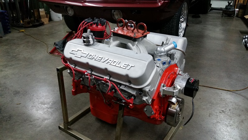

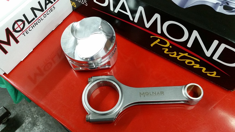

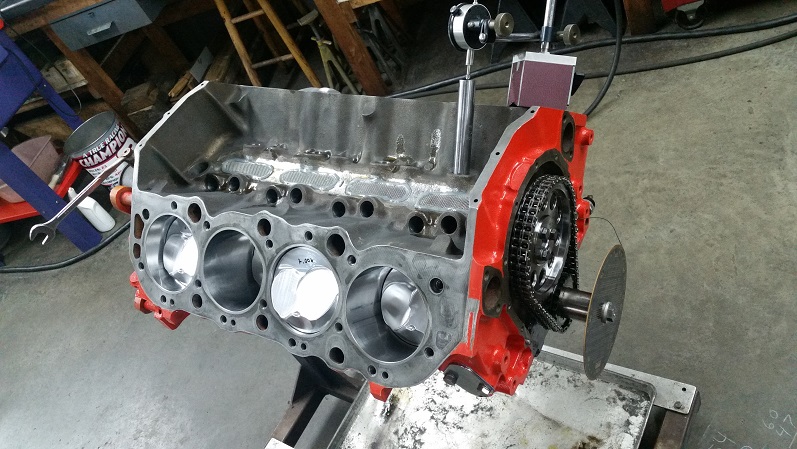

This pretty much brings it up to date. I'm going through the whole car getting it ready for SCR20. All of the upgrades are just for this event. I've raised the compression ratio by at least 2 full points, lightened the rotating assembly, added strength to everything that I thought was weak and added as much power as I could while trying to keep it a street car. I didn't add any cubic inches to it because I like the 427 number. That is what the Corvette and COPO cars had and I like that. I've changed the crankshaft, rods, pistons, cam, lifters, valves, valve springs, locks, carburetor, ported the heads and several other things. The last picture shows the engine as it sits today, waiting to go to the dyno on Friday. I'm hoping for 600 HP, but I really want it to just stay together. I don't have time to go through it again before SCR20. The electric water pump is just for dyno use and will not be on the car.
