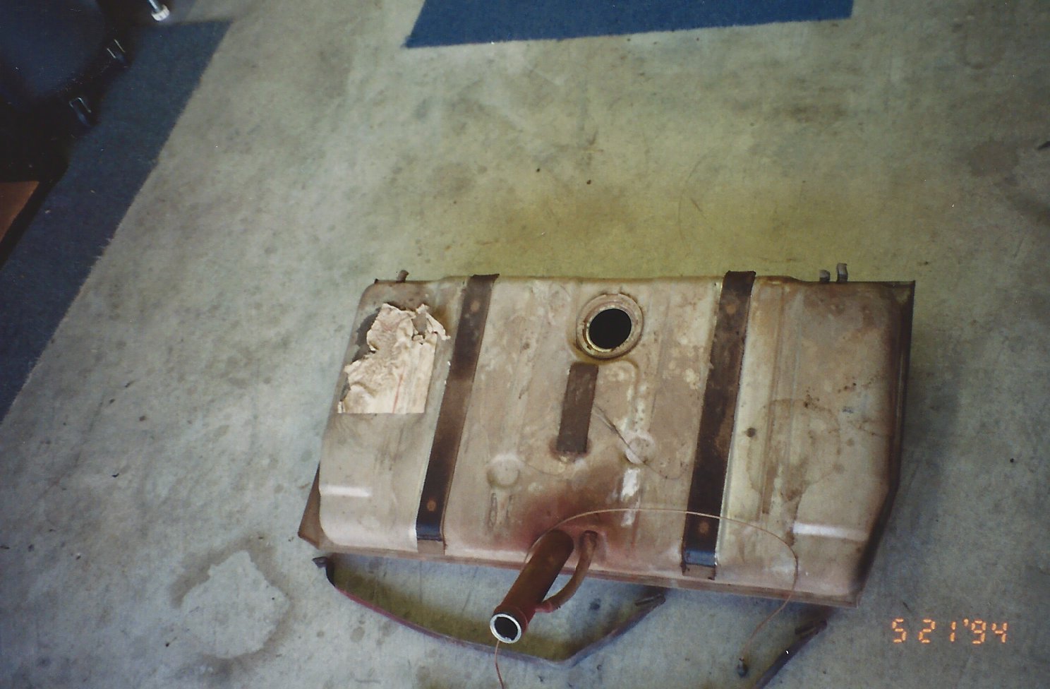

Don't go for certain by the buildsheet notating NA-9 charcoal cannister there...That's no indication it actually recieved it,but rather just that it was assumed to be maybe sold brand new in,or near California.
It's obviously not an E.E.C. tank anyway.

So a VN built '70 Camaro tank. With the codes, 'Bird would not be the original application. Would it be the same tank or would Pontiac have a different configuration ?
What is an assembly line tank in this condition worth ? Any opinions ?

The buildsheet showing that specific engine/horsepower shows it didn't come in a 2nd gen Firebird orginally,but that aside,yes,a 2nd gen Firebird would use that same tank I believe.Both it,or 2nd gen Camaro without the E.E.C. NA-9 charcoal canister of course.(No 3 end nipples or bypass hose on the filler neck)
I don't know what someone is or isn't willing to pay for it today.

Here is a 70 Camaro tank but with NA9 option.

Hose on the neck and 3 nipples on the rear ? Wow.

Strictly going by the build sheet and comparing to all other models 1969-1970, my best guess would be a 1970 Camaro. Options all line up and they don't for any other 1969 or 1970 model. Boxes follow the same format and numbering also.

ditto, Van Nuys built 70 Camaro SS350 4 speed, possibly RS with that tape (door handle)

That fuel tank sender does not look like my 70 VN Z28. Mine looks like a 69 sender. I am away from my tank, but will look at it when I get home.
