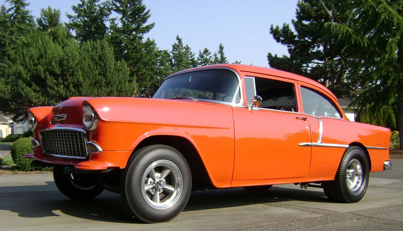

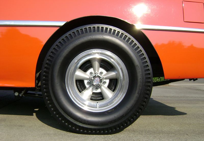

This is an old (actual original) 15x6 TT that was restored. Shot first with a dark gunmetal gray by the wheel restorer then fogged over by me with a rattle-can of silver argent to get that glistening &quot;as-cast&quot; look on the spokes:
Different wheel (a new, backdated 15x5 TTO) with the dark gray mentioned above:
The 15x8.5 (or were they 8s?) with the same argent silver treatment:
The car, since sold:
IMHO, out of the box new wheels, TTOs or whatever, can benefit from a little customizing with paint. It can set your car apart from the others and disguise new wheels as maybe being older versions.

Bill, those old TTs look awesome.

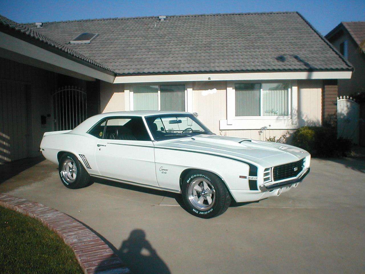

I usually go with the new 15X7 American TTOs with the natural finish on the spokes. They have been a little hard to get because of the finish but I have had the best of luck with the fit and quality of the wheels when I put them on a Camaro. Most of the time I run P215/65/15 or P225/60/15 with a little rubbing in front and I have run 255/60/15 in the back with a little rubbing depending on the car but I have run P245/60/15 with no problems. I have had better luck with the new wheels made in China than I have had with the originals because of the thick flanges on the originals.

Looks great Mark!

Thanks Bruce. One of those cars I wish I had not sold. Non numbers matching big block SS/RS that I put a 540 in.
