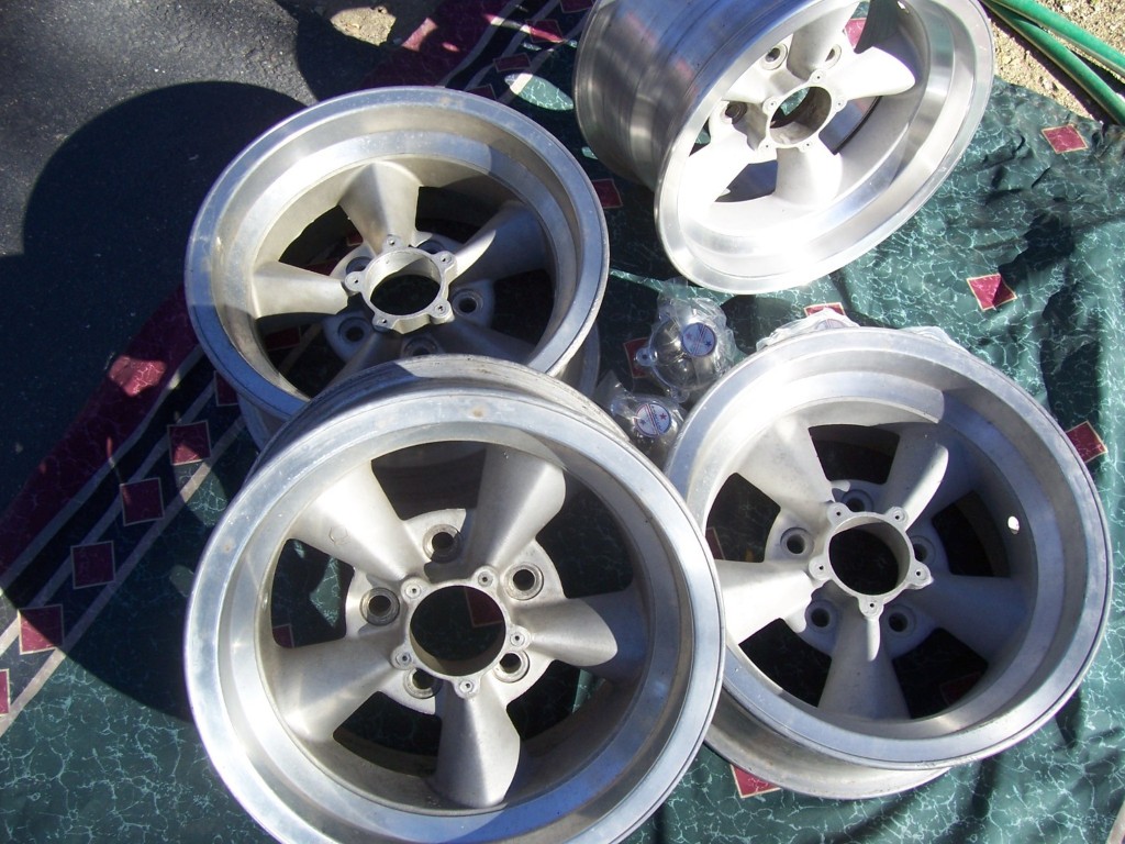

FYI, If you end up needing the shank lug nuts go with .55 in shank length. Between the older American wheel thickness and the washers it worked fine. Still thinking about making some hub centric rings up to center the wheels because there is still some movement with all 5 lug nuts in place before they are tightened up.

Sorry I missed this. I kinda dropped the ball on this ,as we are getting ready to go racing this week-end. I need to measure, cause I'm starting to think that someone has drills these out for 1/2 inch studs. I need to measure the the hole diameter. Anyone know what diameter it should be for 7/16 tapered and for shanked bolts????? They should be different , right????

I believe it is .687 for the shanked lugs. I usually run a tappered reamer thru all of mine to run only that style lug. I like to run the old skool nuts with a almost flat head.
