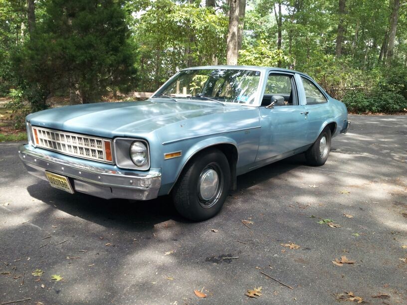

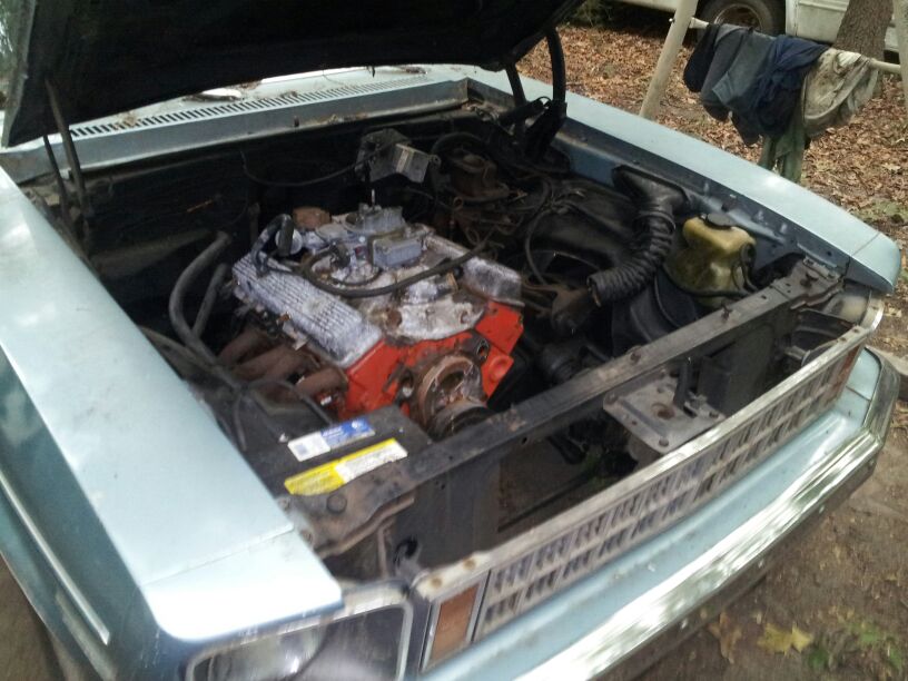

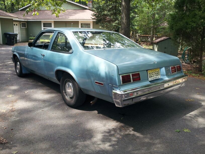

Default Re: Disco Nova fans.

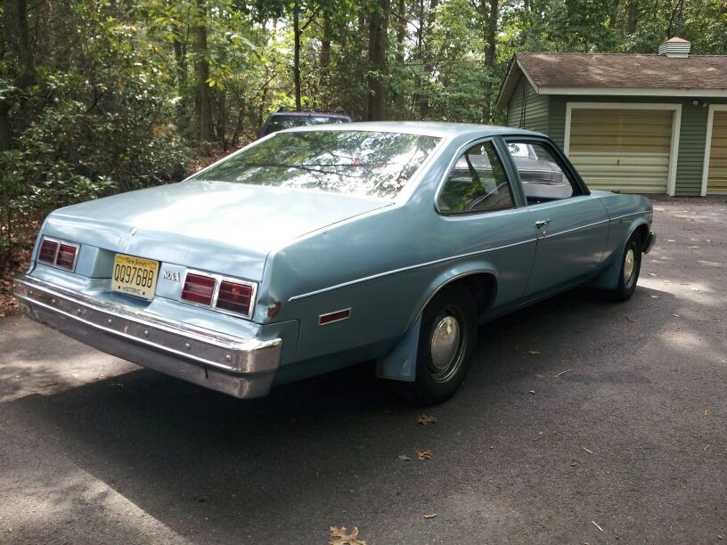

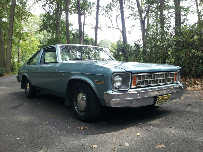

Here are some current pictures. I even left the stock 6cyl tail pipe hanging.

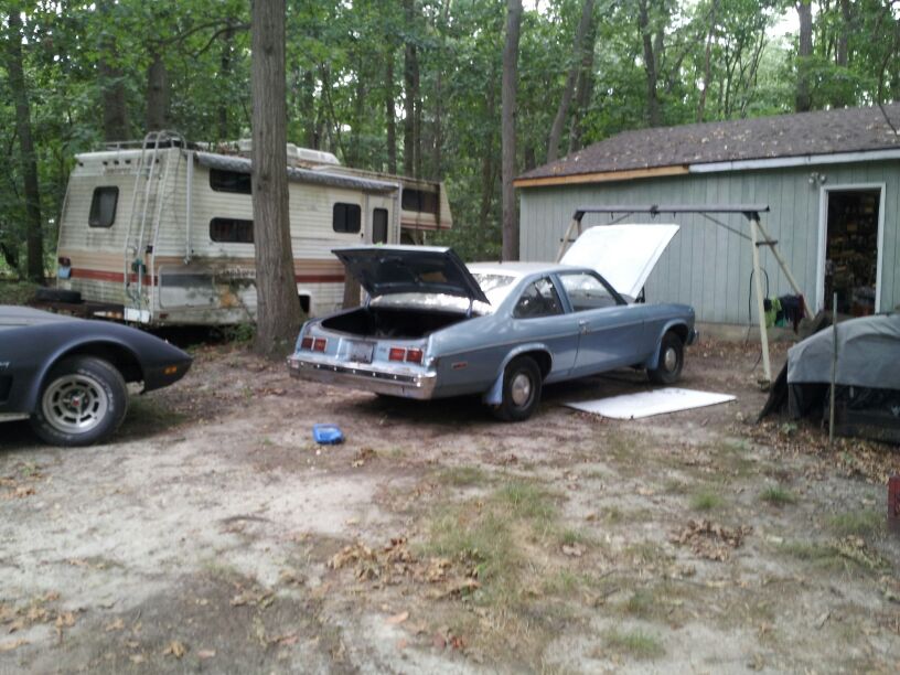

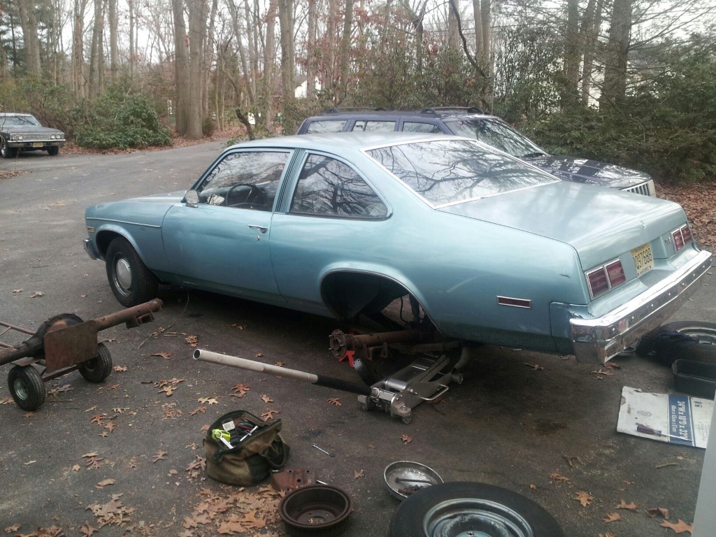

Here is a pic of the rear swap. I didn't paint the other rear at all just so it looks like it was never out of the car to begin with. The 8.5&quot; is sitting on the hand cart.

Good idea to swap in the bigger 10 bolt. My buddy's car definitely had the 8.5&quot; - I didn't realize any of the Novas came with the 7.5&quot; rear.

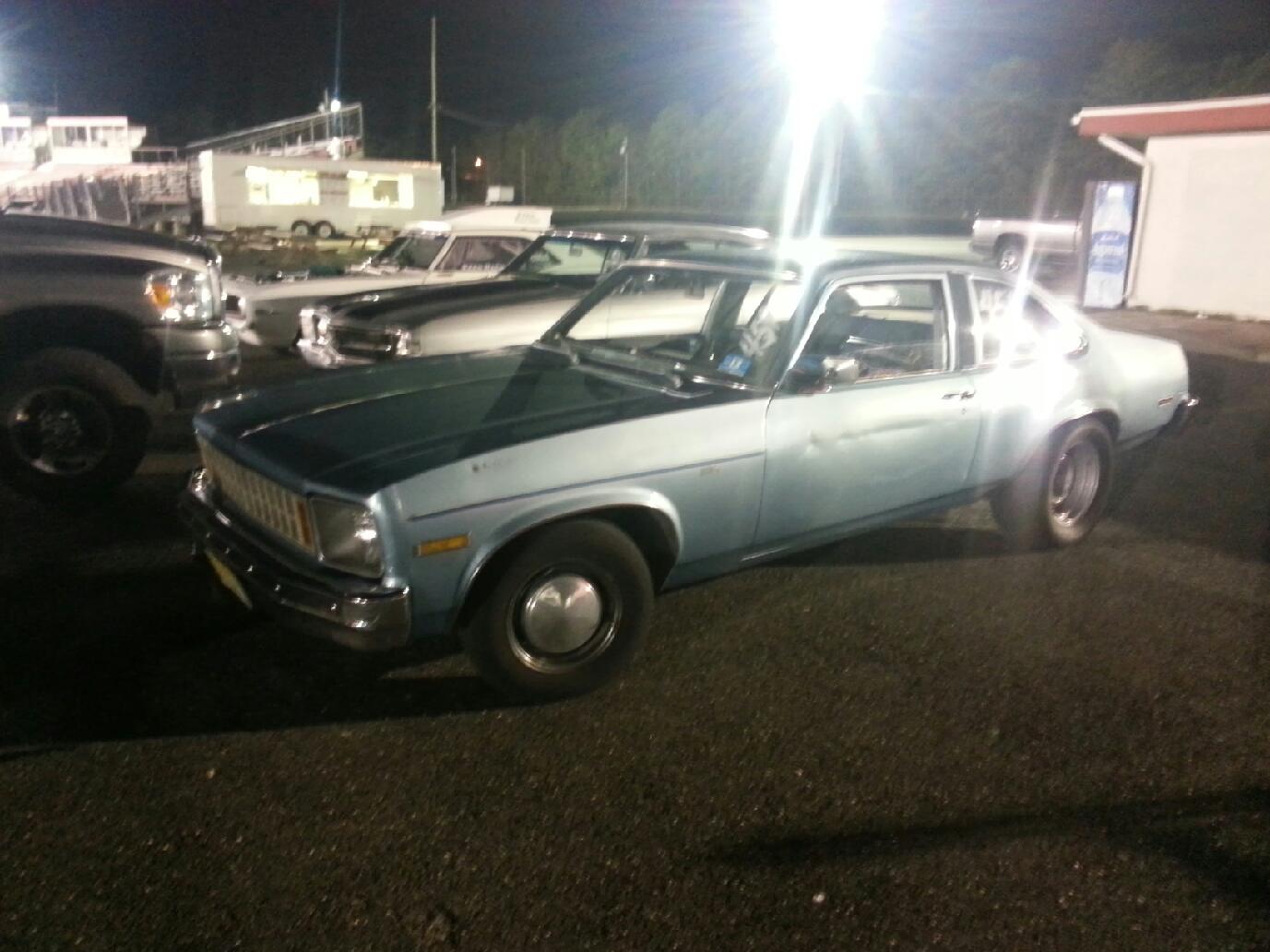

Another update.
The car's previous best with just the engine swap with a stock 6cyl drivetrain on 14&quot; stock tires it went 14.394 @ 94.2 mph with a 2.087 60 foot.
With the B&amp;M transmission shift kit, the 3.42 posi rear, a set of crane roller rockers (got rid of the roller tipped rockers), and some 275-50-15 drag radials, it went 13.407 @ 99.44 mph with a 1.933 60 foot flashing the converter. It was falling over on its nose before the traps so it was running out of fuel. I kept raising the float levels to get it to stop falling over but it started running really rich. It really needs a fuel system upgrade. It has a parts store $13 pump on it and a cheapie glass filter with some bogus lines running to the carburetor. I feel it will pick up some MPH and maybe a tenth or two with a solid fuel system.

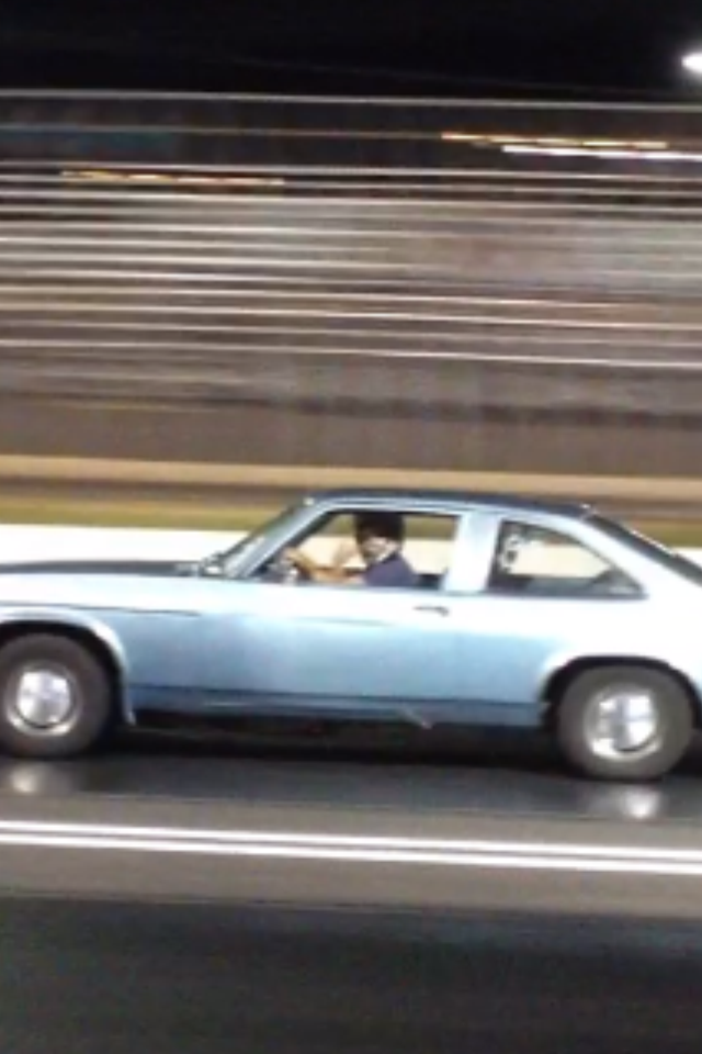

  #20
Old 04-10-2013, 03:35 AM
Fast67VelleN2O's Avatar
Join Date: Mar 2007
Location: Mullica Hill, NJ
Posts: 4,114
Thanks: 7
Thanked 188 Times in 94 Posts
Track pic.
