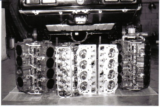

If it works, this is the pic Lance 'midyr' posted here previously of some of the stuff he got from Geo. Eaton's CanAm team..
