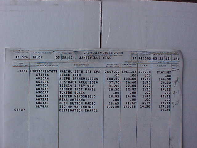

Here is the sheet on my 65 Chevelle all the rpo's are there and the suffixs are there
