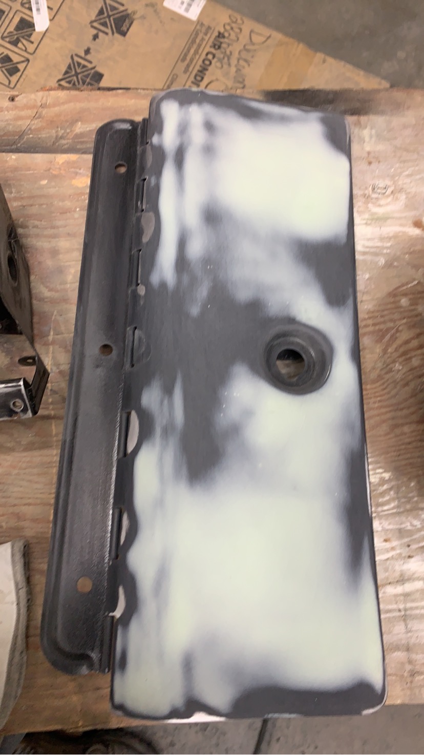

Glove box stripped epoxied and bodyworked (this car had a rough life )

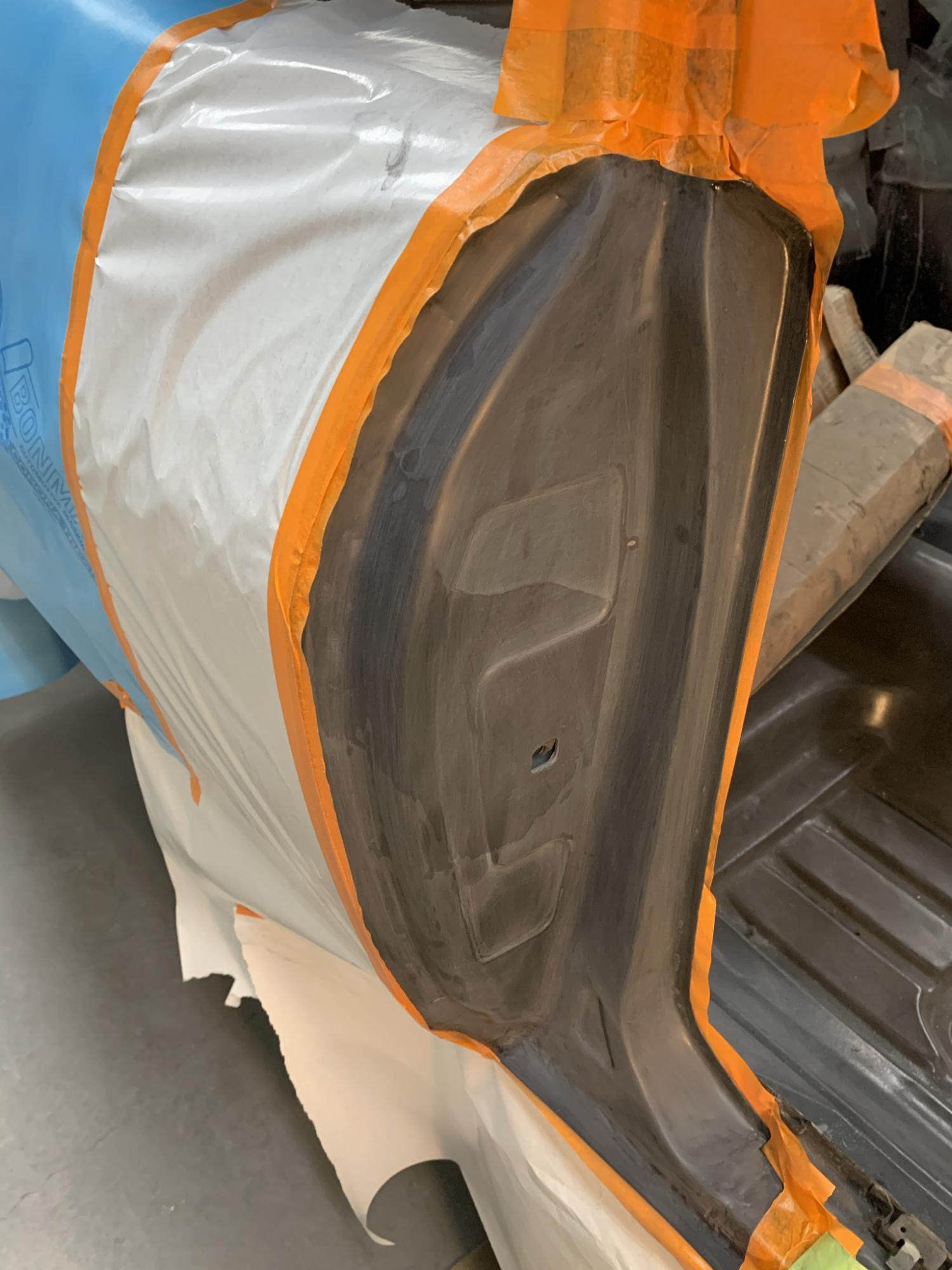

Some final sanding and touch ups in high build
Re-prime some bare spots in the jamb
Sanded out

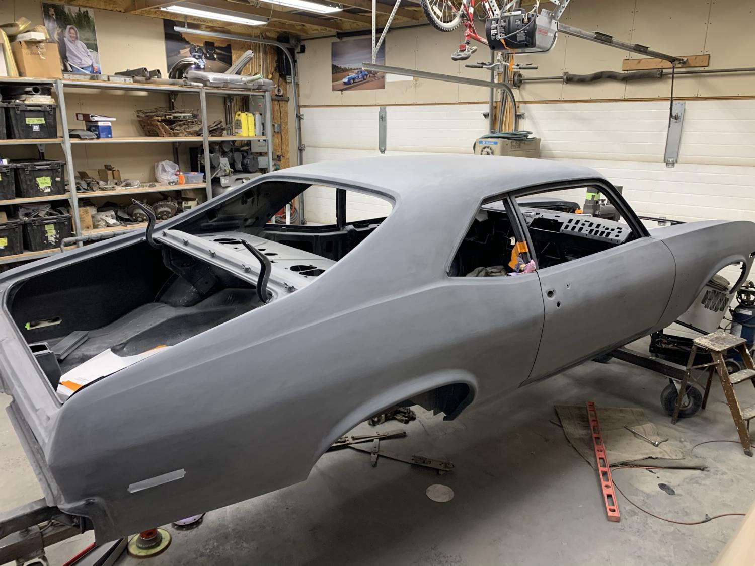

Everything sprayed in a final coat of epoxy sealer.

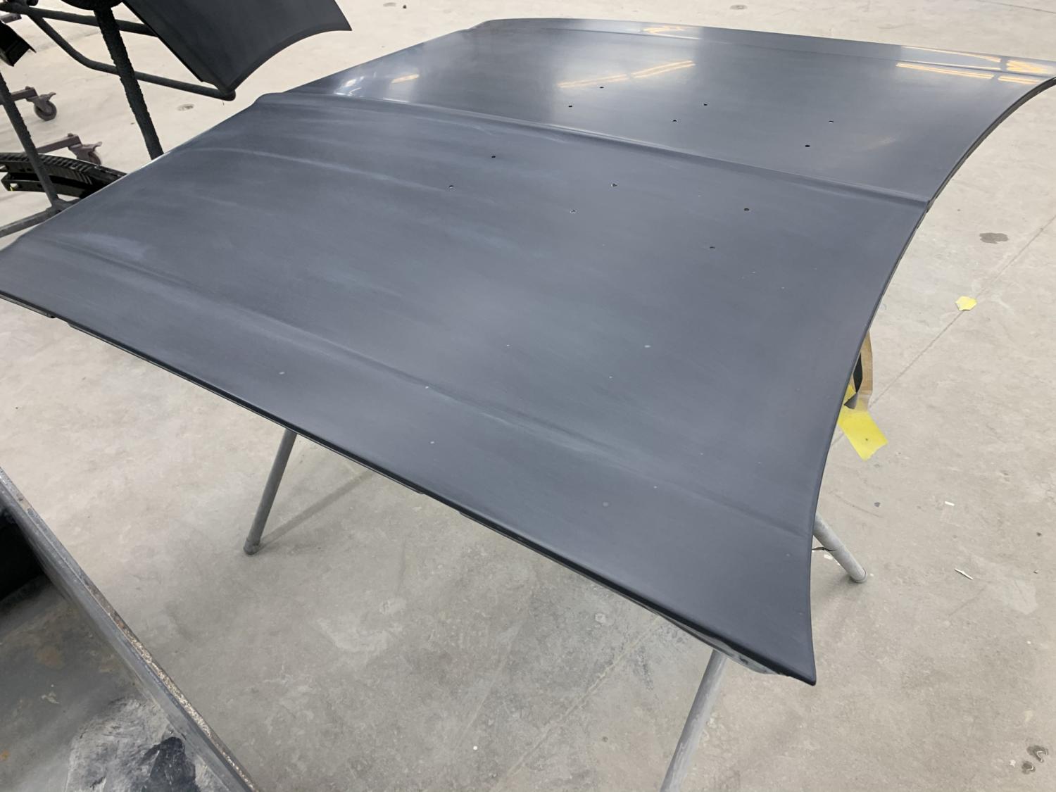

Every square inch wet sanded to 800
Very Excited at this point !!

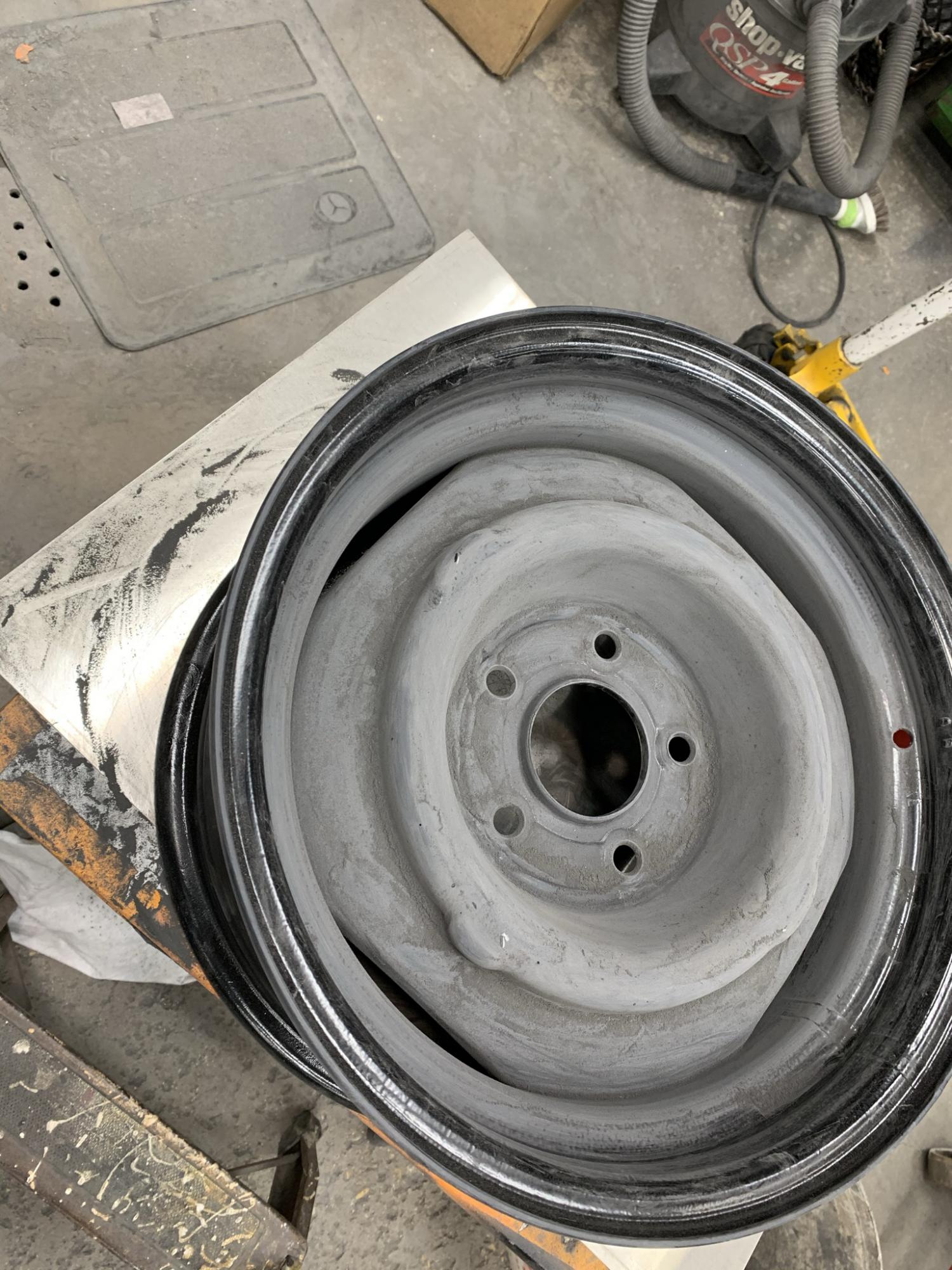

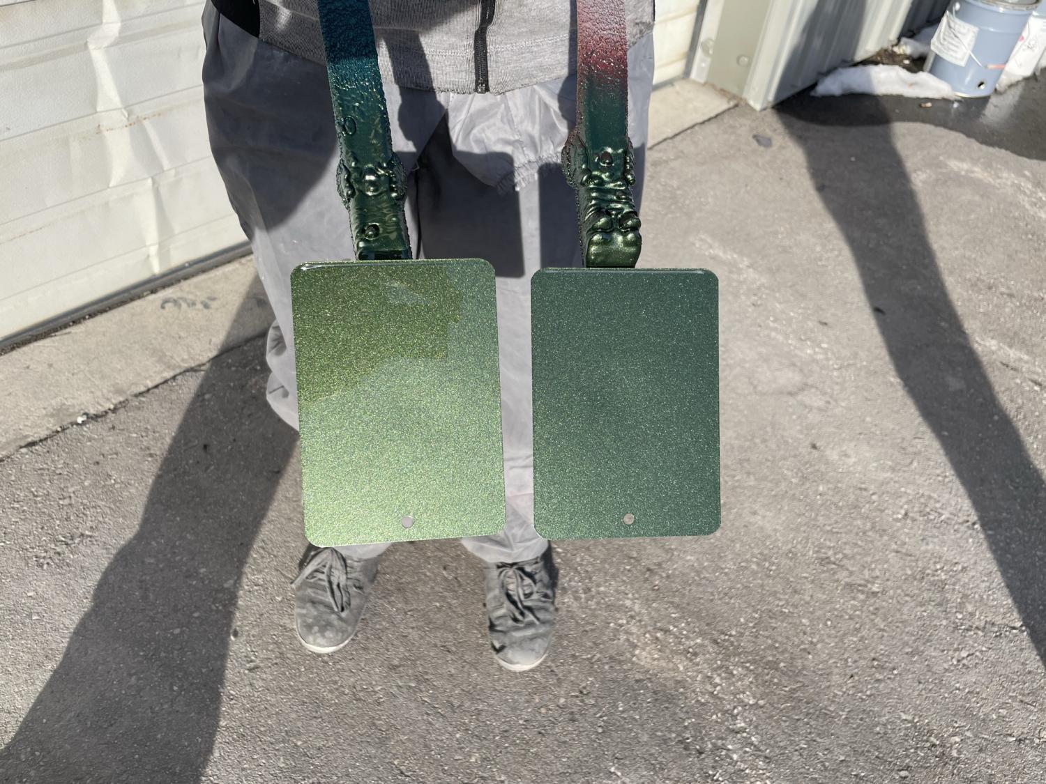

Prepping wheels.... YUCK

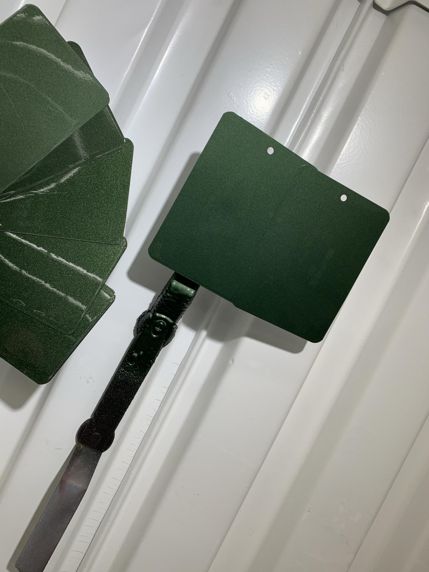

Sprayouts are much more interesting
Once I got them away from the large flake we got it nailed
We were working from an original dealer color sample book with huge coupons.
