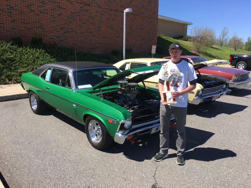

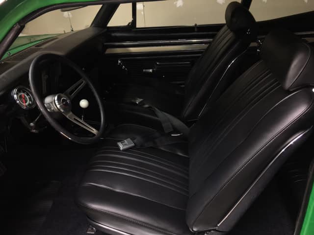

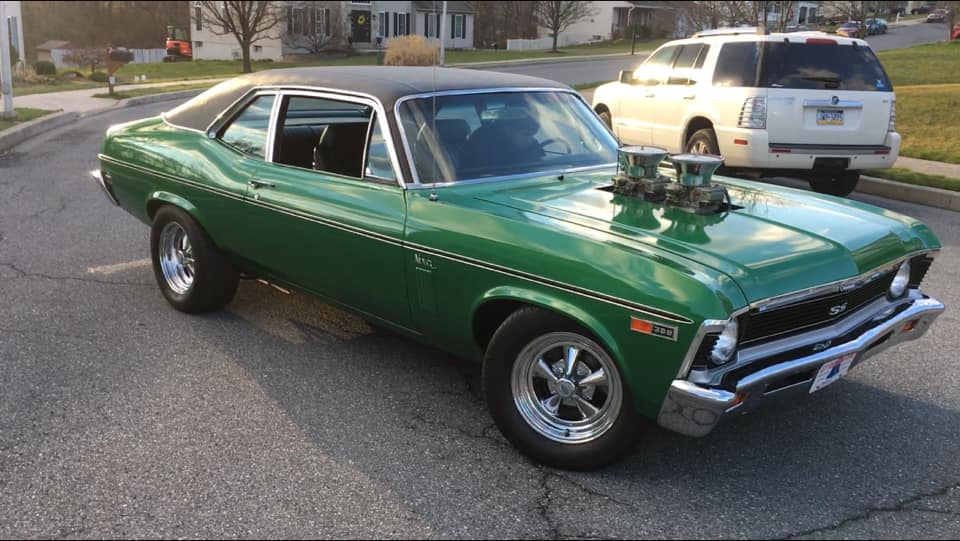

It's been a while! Benjamin is a bit older now so I put him to work on his car. Over the last few years ago we pretty much finished the underside, and had the transmission and rear completely overhauled by Jody's Transmissions here in PA (well recommended) and got it back down on 4 wheels. This year we plan to pull the frame, rebuild and reinstall.
Kids grow so fast - I'm running out of time. Benjamin will be 10 this year!

Looking good,this part takes the longest,its worth it.

Looks great Marlin - reminds me of the car that my daughter and I restored when she was 14 (now 35!). Best thing we ever did for our relationship - she still loves cars too!
