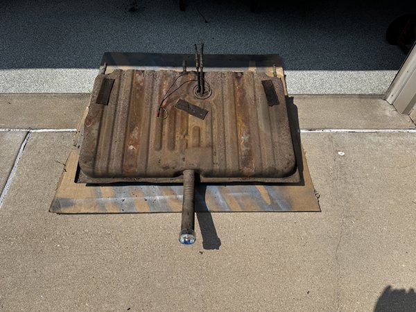

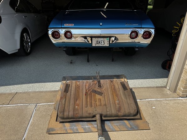

Last fall before I put the car away for the winter I noticed a small gas leak coming from the top front of the tank, which probably explained the fuel smell in the garage...............I drove enough gas out of it and it went away, so I let it be over the winter as it was safe.
I brought the car back home last weekend and in between the various 409 projects I have going I decided to tear into the tank and see what the deal was . Dad and I made a minor repair to a couple of pinholes on the top of the tank after I acquired the car almost 40 years ago and I assumed that patch had finally failed.
I think the leak was actually the original rubber hoses on the fuel sender that had finally dried up as there did not appear to be any other leaks and the gas stain location lined up with the bad hoses. Since I have the tank out anyways I am thinking it might be time to just replace it with a Spectra one and be done with it (the top side of the original tank is pretty crusty) in addition to having the sender rebuilt (or replaced as it is crusty too). Another option is to take the original tank to my radiator guy who can clean it up and check it out, but the low costs of the replacements seem to make that a tough choice even though I'd like to retain original parts...........
Instrument Services who is local to me does the sender rebuilds so I might run up there to see what they think on the sender first and go from there.
While under the car it reminded of what a good candidate this thing might be for dry ice blasting as it was undercoated early in its life...............might have to look into that some more.

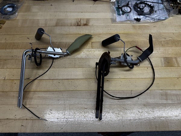

OK..........learned a bit today - sharing for others knowledge if you didn't already know.
Instrument Specialties https://www.clocksandgauges.com/ is about 10 weeks out on their sender restorations and cost is about $350. I can't wait that long, (I brought the Chevelle up for the summer cruise season since the 409 won't be running for a bit) so I ordered a reproduction sender for $50 and going to see how that goes. Based on others experiences with the repro's I suspect after a while it will eventually quit so I'll get my original rebuilt and have it ready on the shelf when the repro gives up.
I picked up the freshly made 409 radiator this afternoon and brought my original gas tank for him to look at. With a fair amount of work (and expense) he can clean it up. The top is crusty enough that he is worried about not having enough metal after the clean up. It won't look original on the outside any longer and it will cost about 2x-3x a new Spectra one, so I ordered the new Spectra Precision OEM galvanized steel tank (Summit actually had the best pricing) this evening and it will be here by the end of the week with the sender. With any luck I'll be up and running again this weekend.
One thing to note - the radiator guy mentioned that on an original gas tank the filler neck extends into the baffle adding stability to the neck. Evidently on the repro tanks the filler neck doesn't always extend to the baffle therefore it tends to be less stable.
Hoping everything fits and works

Received the tank and sender yesterday so I decided to put everything back together last night.
The tanks look pretty similar but defintely not identical. Good news is the filler neck extends into the middle baffle like the originals.
I tested new sender prior to install. Hung it off the tank straps and hooked up power wire to sender then hooked up ground, moved the float up and down and the gauge in the car worked as it should. Installed everything and put 5 gallons of gas in car and the gauge reads empty.
If I disconnect the power lead to the sender the gauge reads full. I had to drill a new ground as the new sender wire was too short to make the old location work, thinking that might be the problem. Ran out of time and patience (doing this on a garage floor) at 10 PM and will try again this weekend......ugh. I love old cars!

Originally Posted by RPOLS3 View Post
I had to drill a new ground as the new sender wire was too short to make the old location work...
I experienced the same thing 15 years ago when I got a repro sending unit for my old 69 SS396 convertible. They make all the rest of the sending unit correctly and then 'cheap out' by making the ground wire a few inches too short! When I called whomever I bought the repro sending unit from, they claimed they had no complaints from anyone else on that issue, which I found hard to believe. Solved the problem by returning the repro unit and sending my original to John Wolf in Ohio, who correctly restored my original sending unit. IIRC, I had the rebuilt sender back from Wolf in about 2 weeks. Total cost including shipping both ways was right at $200.
Bill Pritchard
