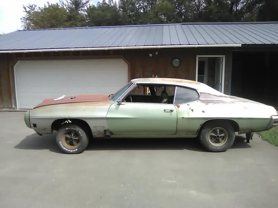

Next project 1970 GTO. I will need a good straight frame original is bent from a previous accident. This car was pulled from a so called body shop. Not a big fan of following someone else's work. A lot of corners cut. I have to fix what I can. You are looking at 16K in work people. I feel real bad for the owner. He was taken for his hard earned money. Just not right! I took the car off the frame today to find the frame twisted like a pretzel. Come to find out it was in an accident prior and this so called body shop was working around it.

Look at the back of this frame hit hard on pass rear. The top of the passenger rear spring perch is actually 5 degrees higher than drivers side. The frame rail is kinked.
