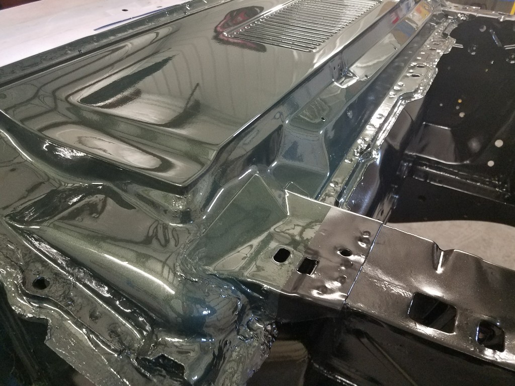

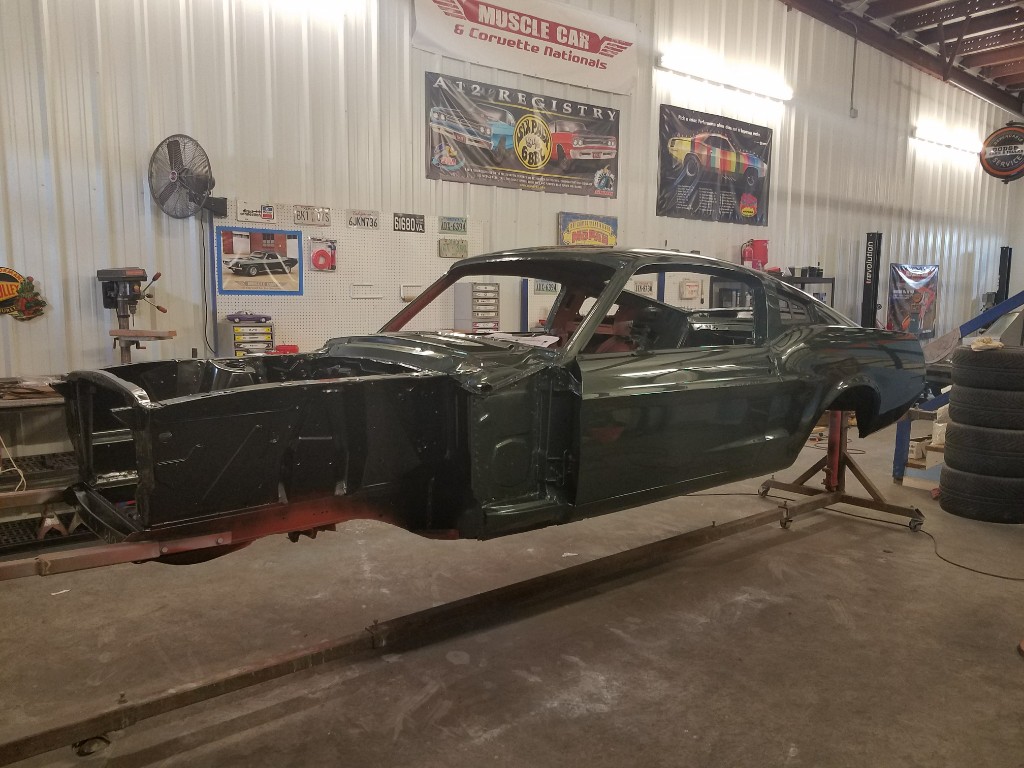

That clear looks great, and you haven't cut and buffed yet, show off . What medium reducer 70 or 85 ?

Wow! Praise from Caesar!!! Thanks Mike! I used 85. The temp in the shop these past few days has been hot enough. I want to try the clear you use next time. That'll be on the Trans Am or Phil's 68 GTO!
Later this week I'll be shooting the engine bay, then off to the Mustang parts place (there is two in town.....not good) for inner fender splash shield rubber so I can spray the sound deadener in the wheel wells, then it's a cutting and buffing time!!! Trying a new shirt throw DA with the 3M Perfect It polishes......I'll keep you posted!
More to come...

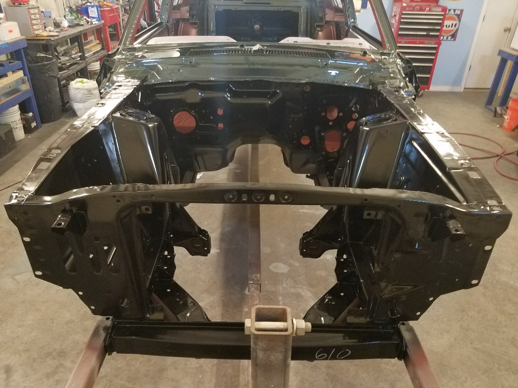

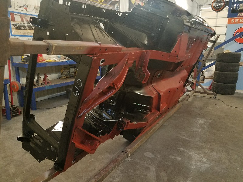

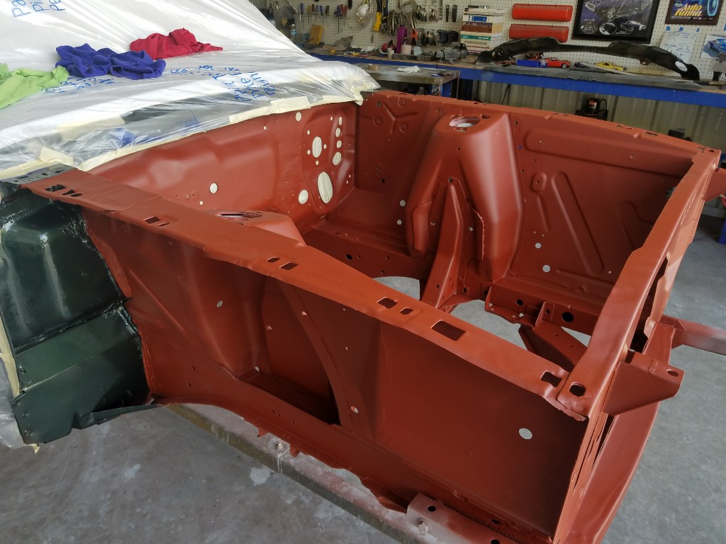

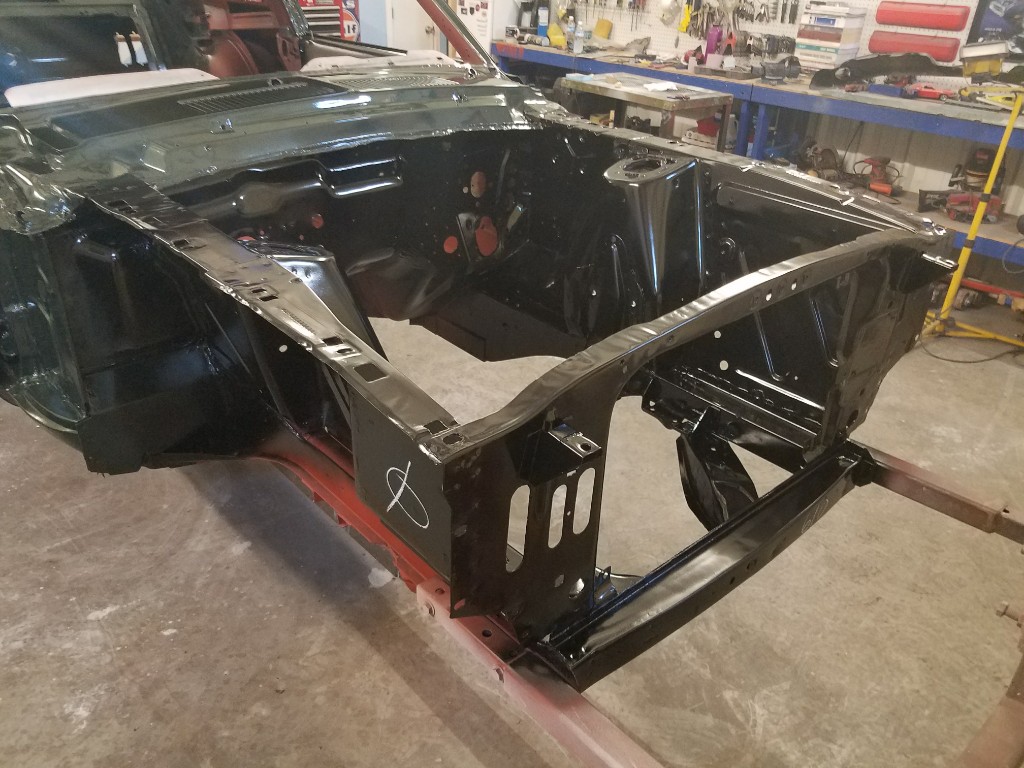

Moving forward, it's engine bay time! I masked off what needed to be masked off with proper masking mask off material..... and proceeded to black out what needed to be blacked out with black out paint. I think that's about what I wanted to say

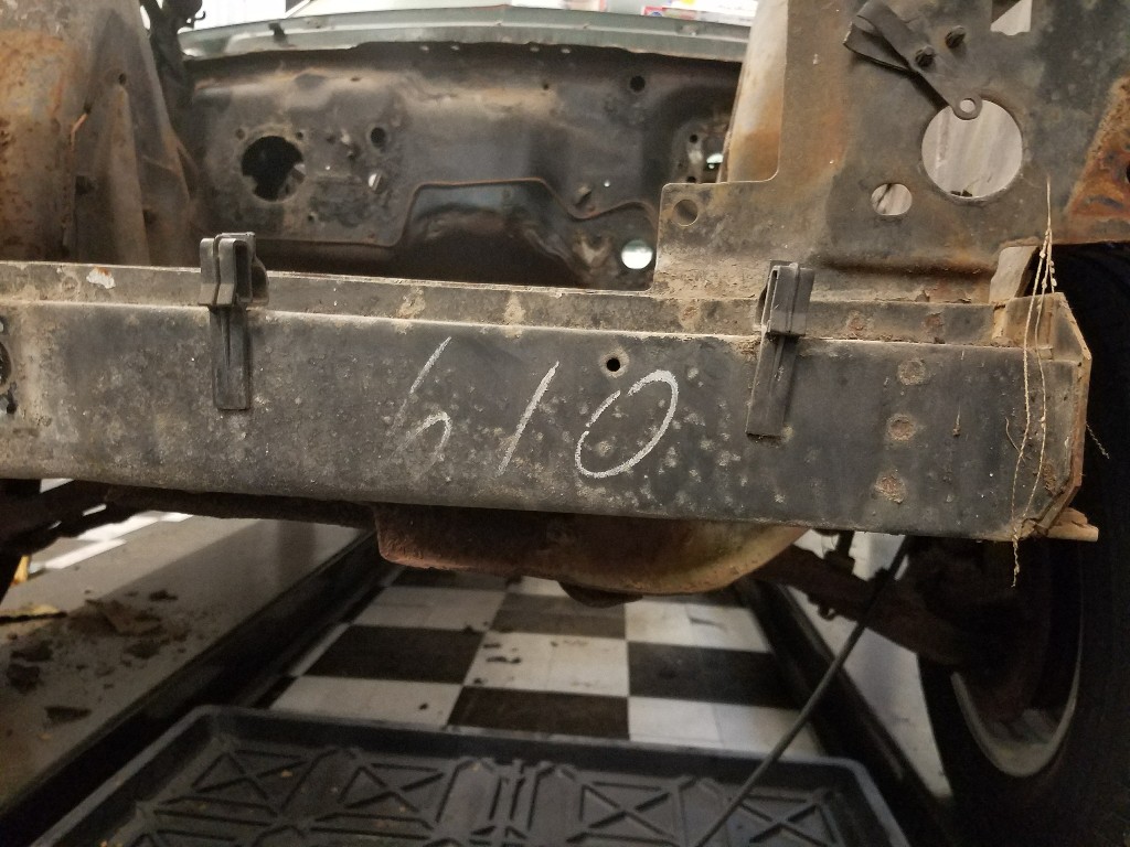

So, looking at my undercarriage and seeing survivor cars [same year... same plant] , I took my notes and laid down the funk with proper overspray and sloppy missed spots. Since the bays were painted from the top downward, the bottom of the frame rails, front crossmember, strut rod brackets, engine mounting perches.... all look black when viewed from the top yet show the red oxide underneath. I tried to replicate that and two factory markings I found as well.
Once I get the fenders on, I'll the spray the sound deadener in the wells, transmission tunnel, and firewall/inner frame areas. More to come!
