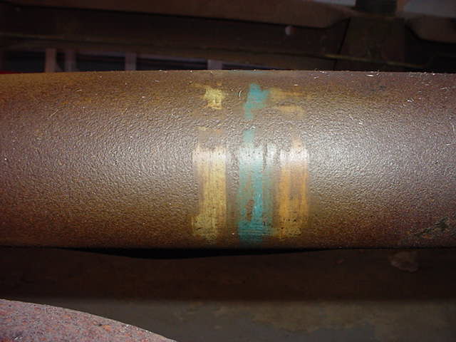

Here is a photos of Chad's (then owned) survivor Yenko Chevelle M21, KQ coded rear and his shaft had these colors. They appeared to be yellow/aqua/yellow or orange. Using this as a guide as well as several other people who provided original survivor photos we painted out shaft.

Originally Posted by SS427 View Post
I have gotten some emails regarding the paint markings on the driveshaft with different colors given. I was able to see at least a yellow and aqua green stripe on my shaft as well as what appeared to be a black stripe. However, this is a photos of Chad's (then owned) survivor Yenko Chevelle M21, KQ coded rear and his shaft had these colors. They appeared to be yellow/aqua/yellow or orange so that is what I went by. If anyone else can provide visual proof of what they should be it would be much appreciated.
Sure its not white, aqua and orange? The colors on the green L78 Camaro were white, green and orange.
I know this is Camaro info but "might" be of some use.. Maybe not.
http://www.camaros.org/driveshaft.shtml
Excellent work btw. Look forward to seeing more of it.

Thanks for the help Darrell but no, the Camaro is definitely different and just a coincidence. I have now received a few photos of survivor shafts and it indeed appears that it was yellow, green, orange so time to fix it.

Rick, I was lost on shaft color codes and then stumbled on a couple sites that spelled out blue/yellow for an L78 shaft with manual (69). Does the COPO use a different u-joint?
  #119
Old 12-17-2018, 11:23 PM
Posts: 10,389
Thanks: 3,299
Thanked 4,867 Times in 1,191 Posts
No, there is nothing unique to the driveshaft or U-joints for a COPO.
I have seen the prop shaft color in box 19 listed on at least 10 or so 69 BAL build sheets as BY, for. L78 and L72, also believe Same shaft was used for all BBC with manual trans. There was nothing different on COPO Cars.
Still trying to confirm for sure, but believe BY is black yellow ?
Color codes were not consistent among Chevelle plants.
If anyone has a 69 BAL BS from ANY car like SBC, that lists a color in box 19, I would like to see if any used BU for blue ? Kind of guessing here.
Thanks for any input for BAL built cars.
