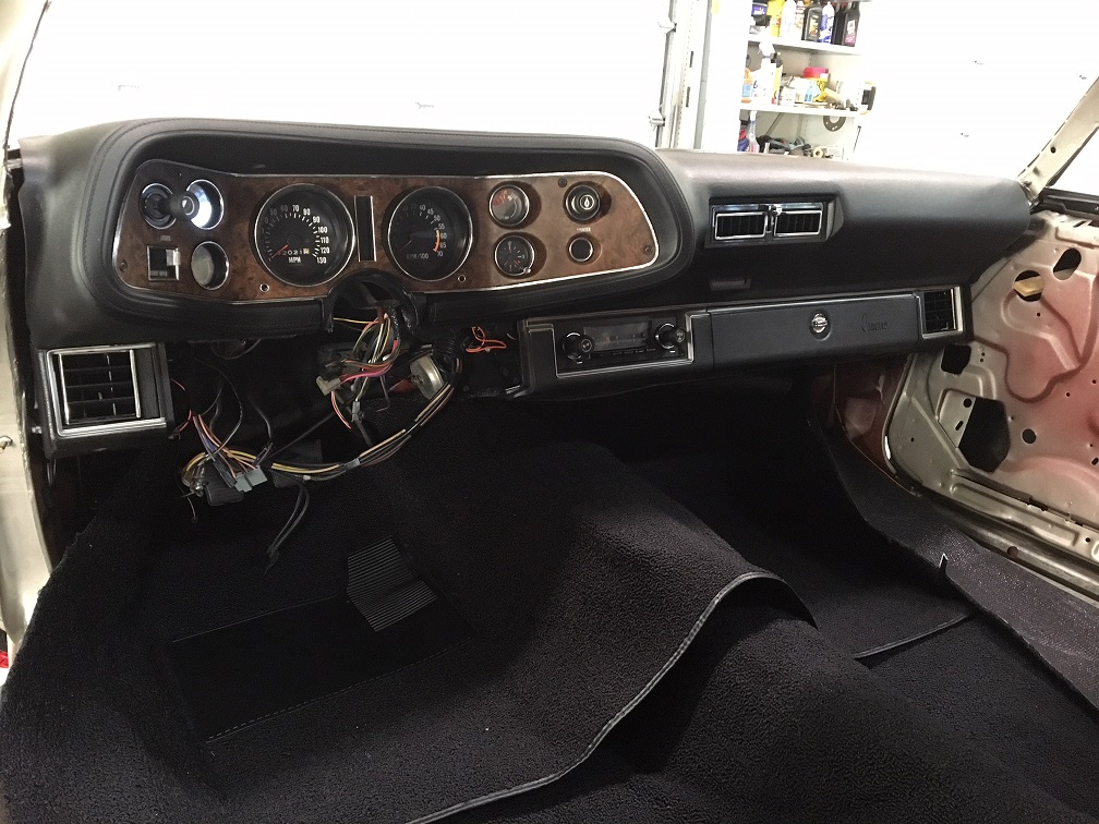

Replated the tail light sockets and replaced the lower steering shaft boot and lower steering column bearing... (same as a Jeep Grand Cherokee)
started putting the tar and jute underlayment in and carpet as well...
