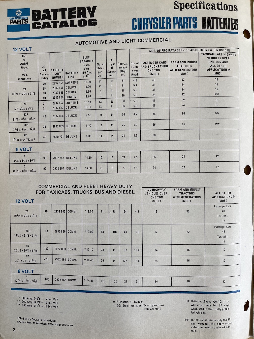

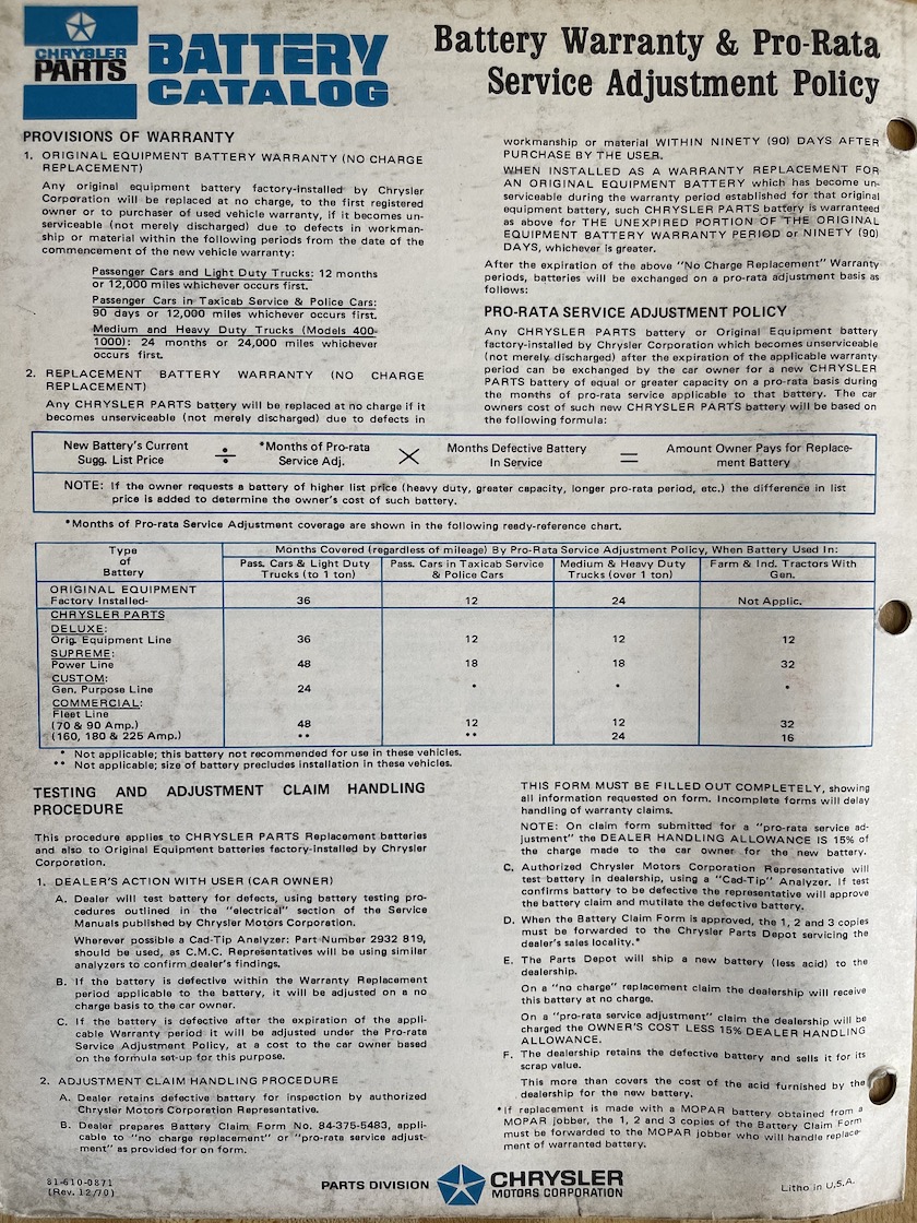

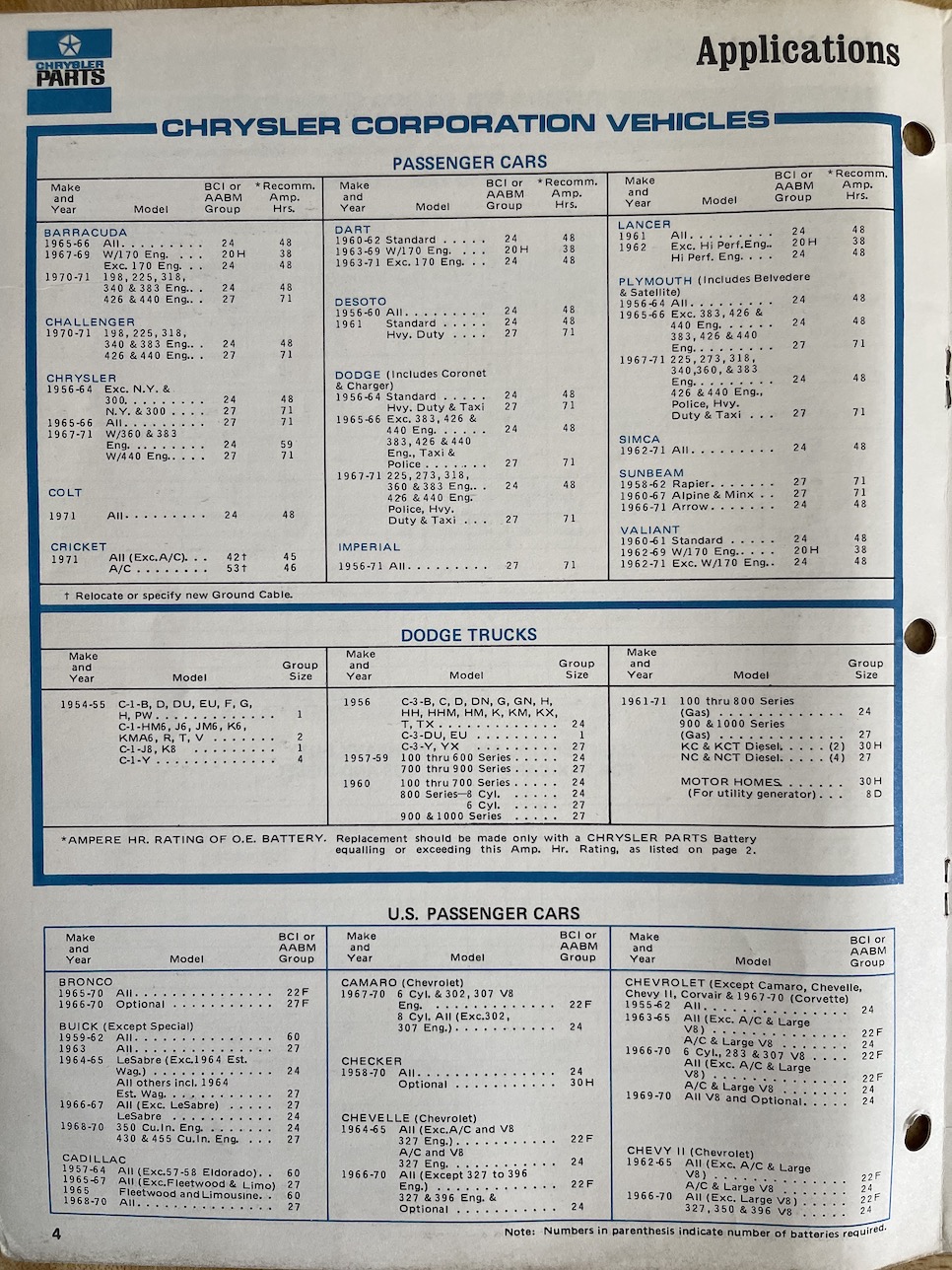

Hey! Yay! The site’s back up! Woo-Hoo! (’Tis a “site” for sore eyes!) Now I can express my enthusiasm for cool, NOS, period-correct Dry Charged MoPar service battery; over what had, originally, been dismay, re: destruction of rare, authentic, production-line repro battery as the result of being poorly (read: not at all) packed by negligent sender, and, mishandled by carrier.
For those who would enjoy knowing what Chrysler Corp. service batteries of the era looked like, as well as what part numbers they carried, here are 5 pages of the 8-page Chrysler Parts battery catalog; December 1970 printing. (The 3 pages which I’ve omitted are non-CP logo batteries, as well as other-manufacturer (i.e. domestic: GM/Ford/Checker/Rambler/Studebaker+ & imported: Fiat/Jaguar/MG/Sunbeam/Triumph+) applications for the batteries listed. In addition to the aforementioned, there are listed applications for items as diverse as farm equipment, outboard motors, and, golf carts.) The catalog, further, includes activation & testing information. I thought that, perhaps, it may prove of interest.

Thanks Bob. It's interesting that the factory replacement battery immediately went to a three vent cap in 1970 instead of the assembly line individual red/yellow/green screw-in caps.

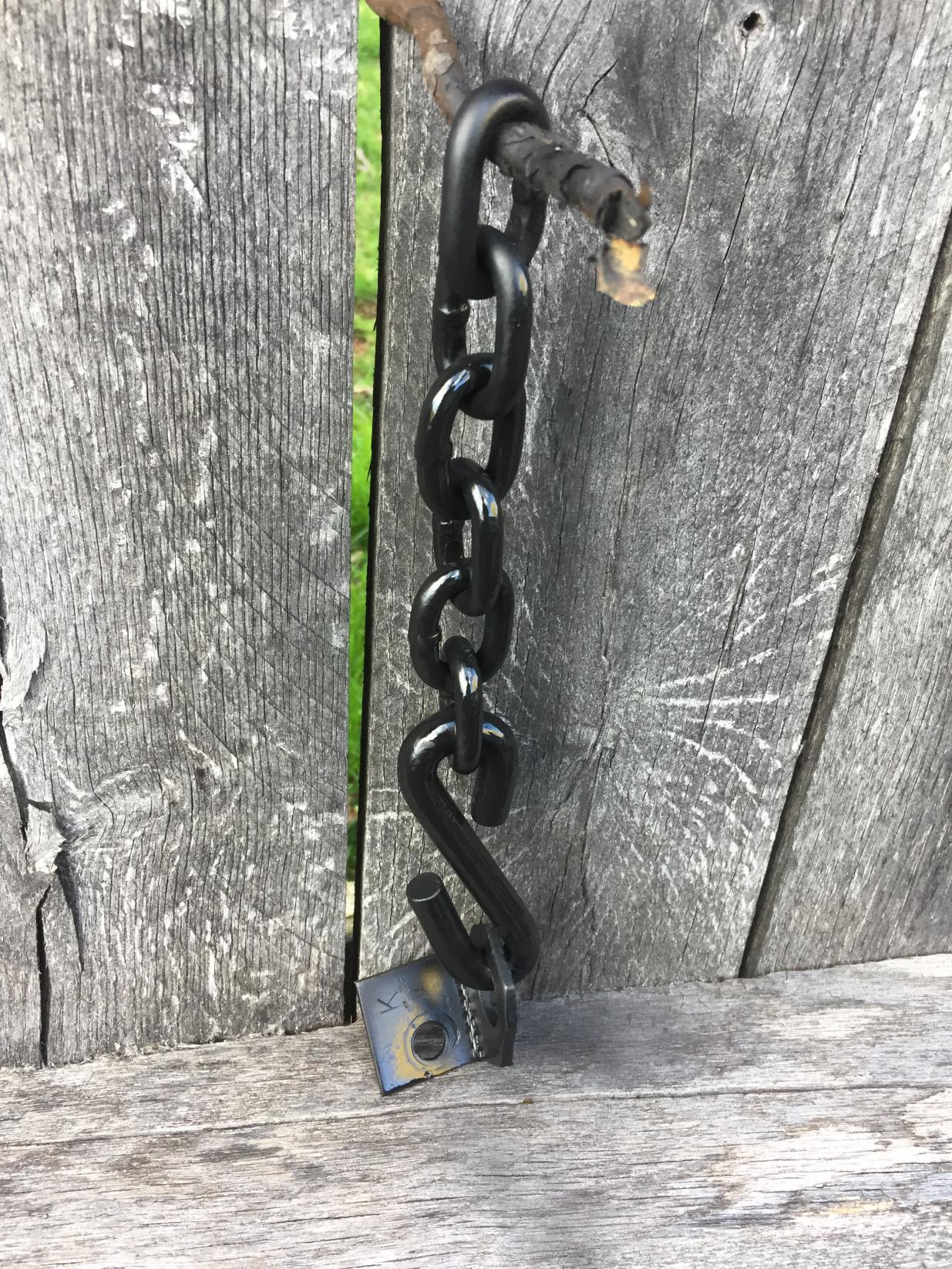

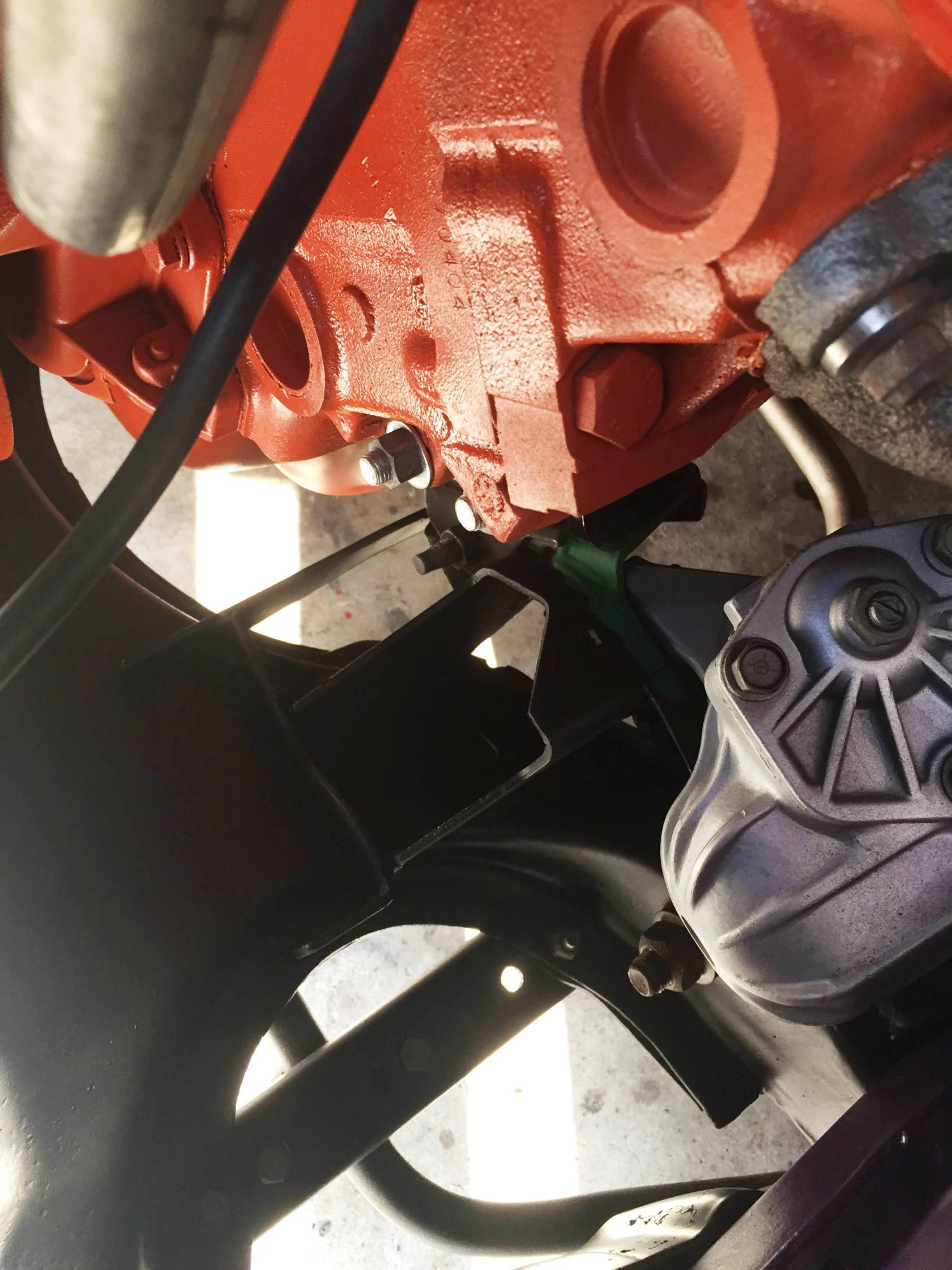

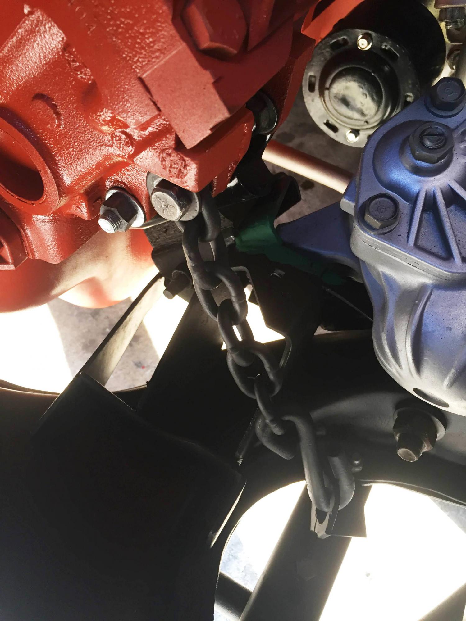

After driving the car around, I see that under "spirited" acceleration, the shaker almost hits the right side of the hood as a result of the engine torquing against the rubber engine mounts.
Since I dont want a replay of what happened to my 71 383 ragtop 40+ years ago, where the left mount snapped and the shaker smashed into the shaker trim ring and cracked the shaker dome, I decided to make an official, vintage, Day2 torque strap out of old engine hoist chain and a smallblock Chevy intake mainifold engine lifting tab.
( I also ordered a set of MityMount locking engine mounts that hold together if the rubber separates)
But the chain looks cool for the time being.
And no new holes were drilled or animals harmed during the filming of this project.

Tested out the chain and it had too much slack in it. The shaker still moved waaaay too far over under load. So I cut a link off the chain at the top and then spaced the engine lift bracket up a small bit with two hardened washers between the sway bar support bracket and the engine lift bracket. That gave me just enough slack that the chain was not tight when both ends were attached.

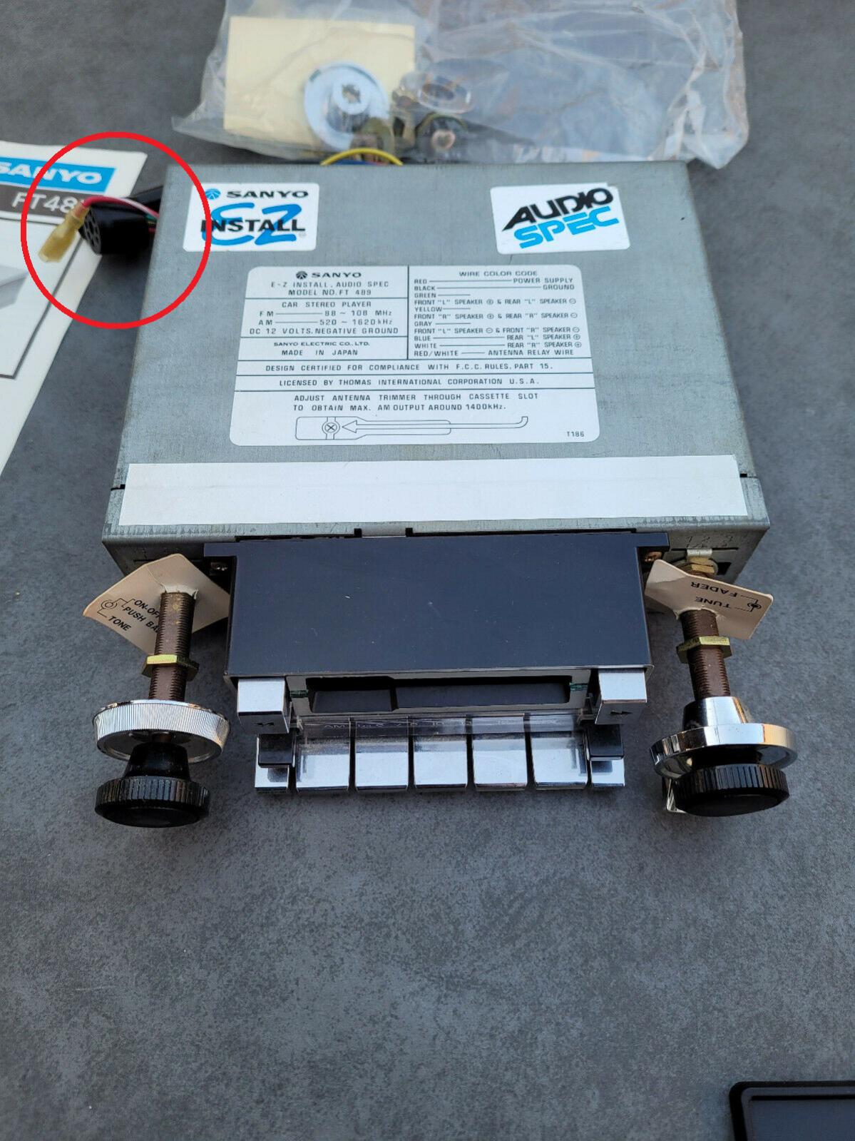

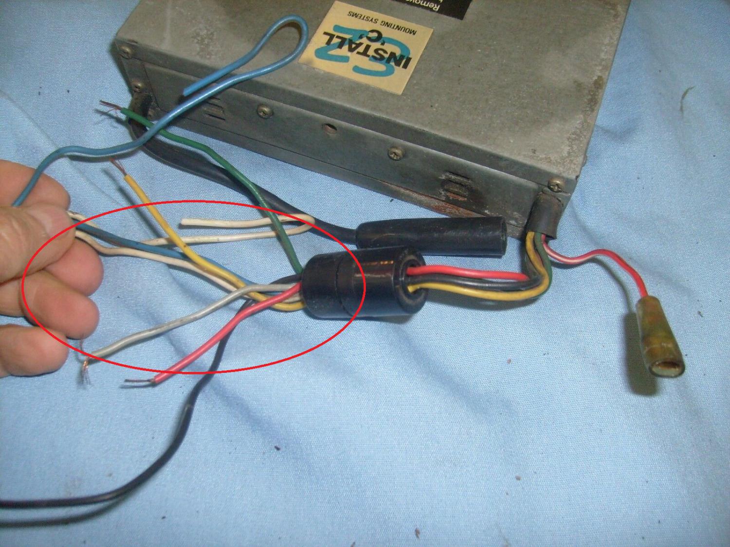

I just found an NOS Sanyo FT489 (circa early 1970's) for the purple Cuda. It is missing the male half of the quick disconnect harness attachment that you would splice your power/ground/speaker wires into.
Does anyone have any idea what precisely this barrell-shaped, male section of the connection is called and where I could locate one? I believe it has 8 or 9 prongs.
The first photo is the Sanyo I bought, The second photo is off the internet of a complete harness with the section I am looking for.
Thanks for any help.

To address your inquiry, it's called a "multi-pin connector." (It appears to be way too big to be a DIN connector, which is a kind of multi-pin connector, an example of which is the connecting cable on the Chrysler cassette player/recorder, circa '71, as was in your hemicuda convertible.)
As far as sources are concerned, perhaps try contacting Parts Express, as they may be a source for what you need, or, if not, be able to provide a helpful suggestion. https://www.parts-express.com
My only other thought, if the above is not viable, is to search for a complete non-working unit which you may be able to acquire on-the-cheap, simply for it's parts. (I hope that this helps.)
