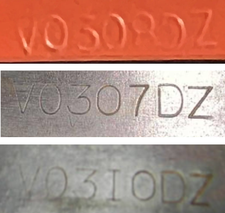

Originally Posted by dykstra View Post
I was waiting for William to call that one out.
Yikes I'm getting a rep...
Look no further than the obviously re-stamped block pad. In 30+ years of logging data, do not have a DZ engine final-assembled Saturday, March 8, 1969. For comparison, here's March 7 and March 10th. Con VIN would have been at the oil filter, different stamp font.
I also don't believe a carb dated the second week of February 1968 could be original to a car built 500 days later.
IMHO the body tag has been altered to show a 712 interior. As noted, has been off the car and re-installed with hardware store rivets. Too bad they forgot the RH dash woodgrain included with the Z87 interior option.
Lots of other issues.
The first things I noticed 711 was changed to 712 and oops forgot woodgrain on PS lower dash. Not much to like IMHO
