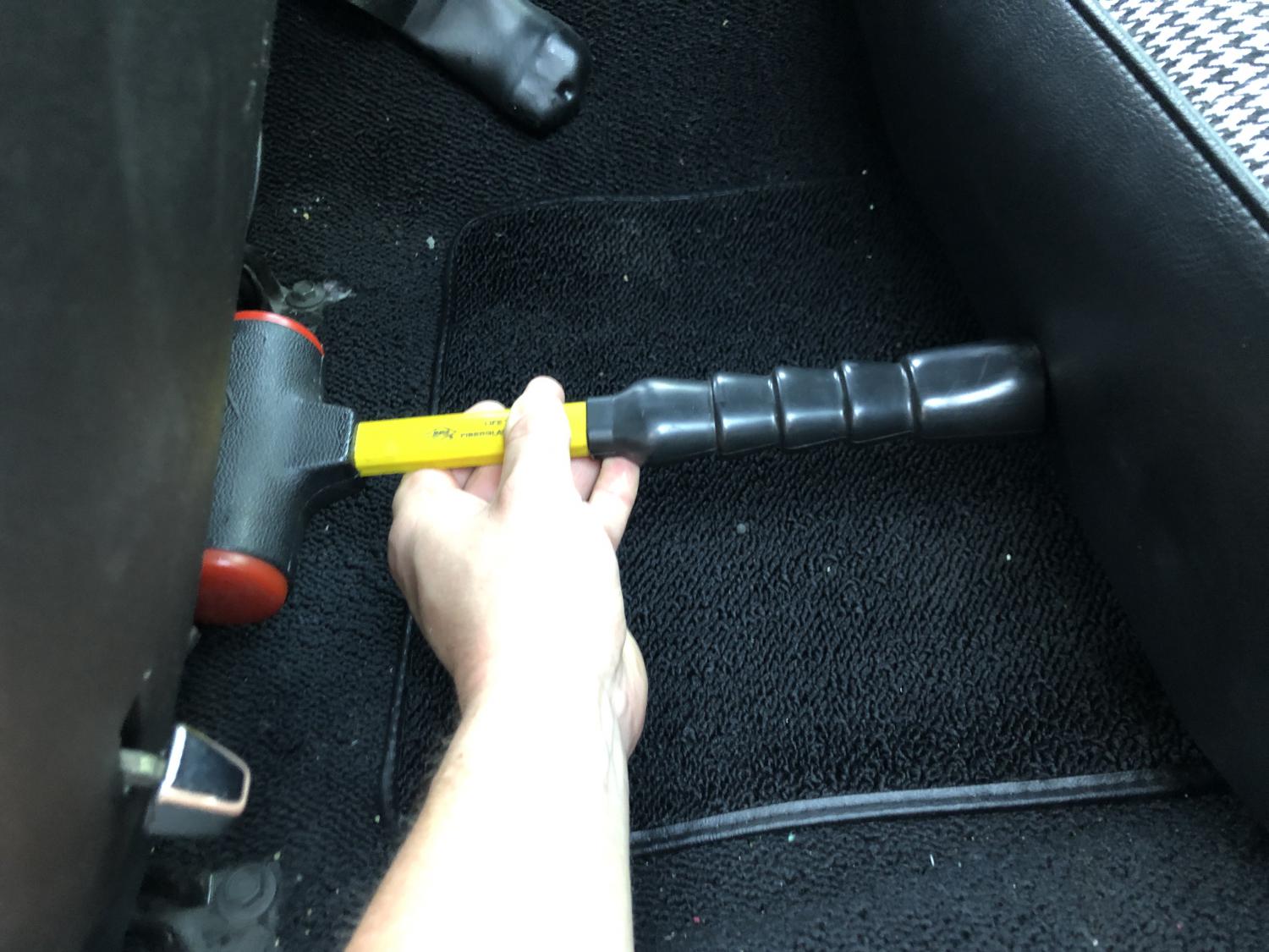

As we mature, ok age, there are some tasks that seem more difficult. Here are two that I've been working on presently:
Working under the dash removing aftermarket stereo and installing original radio and speakers. Crawling under the dash installing the dash speaker and radio or crawling in the trunk to install the rear speaker.
Carpeting installation with console. It's not difficult but tedious. The rear seat bottom removal is never an easy task for me. I know you need to push the bottom towards the back and lift. If you know of a clever way or have a trick LMK!

Steve, you need to push the cushion down at the same time as back, as there is a hook in the floor bracket to prevent it from popping out in a crash. Place both palms on the top to front panel seam, inline with the floor bracket, and give a mighty shove down and back at a 45% angle, ONE side at a time. Once the first side has popped up, do the other, no need to try and lift. They usually pop up by themselves, once they are forced out of the floor bracket.

Thanks Mitch, but I know exactly how they are secured with the bracket. Its never easy, but finally get it out.

I don't think there is a trick for the rear bottom seat cushions...just a lot of grunting and grumbling until it releases. As for under the dash, I'll trade ya...try doing work under the instrument panel of a DeHavilland Chipmunk. I think I took the mindset of "become one with the airplane" a little too literal.
