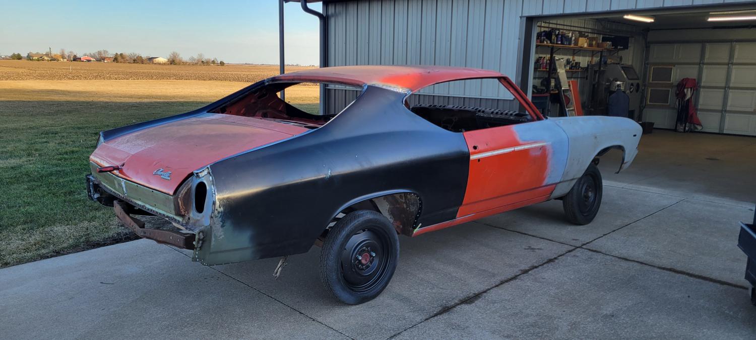

Really wish I could have saved the passenger side but there is just to many issues around the wheel arch, lower return, and both inner and outer wheel houses just behind the wheel. Managed to save the trunk return, and rinse and repeat on making the 68 quarter a 69. I still need to repalce a small section of the inner wheel house and the very outer edge and lower rear section of the outer. More to come. Getting close to body pulling time.

Drivers quarter is now on. Happy with the door gap and face fitment. If you handnt already noticed i replaced the entire rear panel as well because of the trunk gutter being all mangled and the fact the the drivers side was wrinkled up and just couldnt be brought back. Got nice fitment beteween the deck lid, quarter, and quarter extension on to the passenger side now.
Before you do your quarter panel replacement do you replace the body bushing first like so many people suggest to do or leave it as is and replace quarters? Thanks an once again thank you for taking the time to share your progress with us all!

On the RH side i didnt wanna replace the entire wheel house as there was just some rust on the outter edge and the lower behind the tire. After that sand blasted the entire area, primed and put the quarter on for the last time.

After I was happy with gaps and fitment, everything got welded. Still have some screws holding the trunk returns and arch areas. Easier to do the welding on the body twirler. Very happy with how the trunk and quarter extentions fit.
After that I pulled the Body today. Underside of the body is perfect! Almost no rust. Frame is similar condition. Probably get the frame washed and torn down next.
