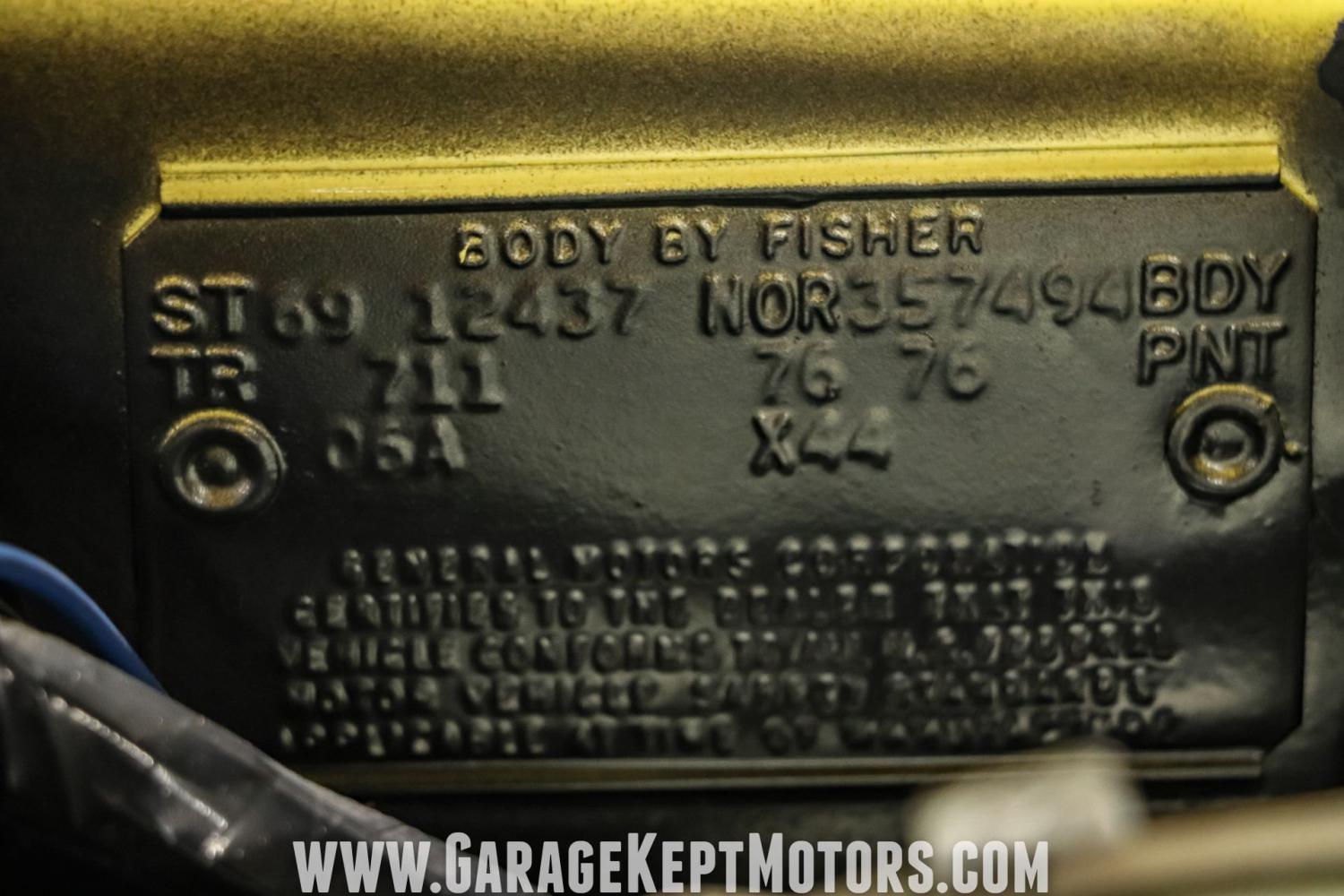

Trim Tag

I just looked through all the pics. BE axle has an 0421 date on it - POP has 0527. Queen City COPO, looks like the trim tag has been off. Auction description says it was restored back in 2008. Anyone know the history on this one?

Tag looks good, the rivets do not.
