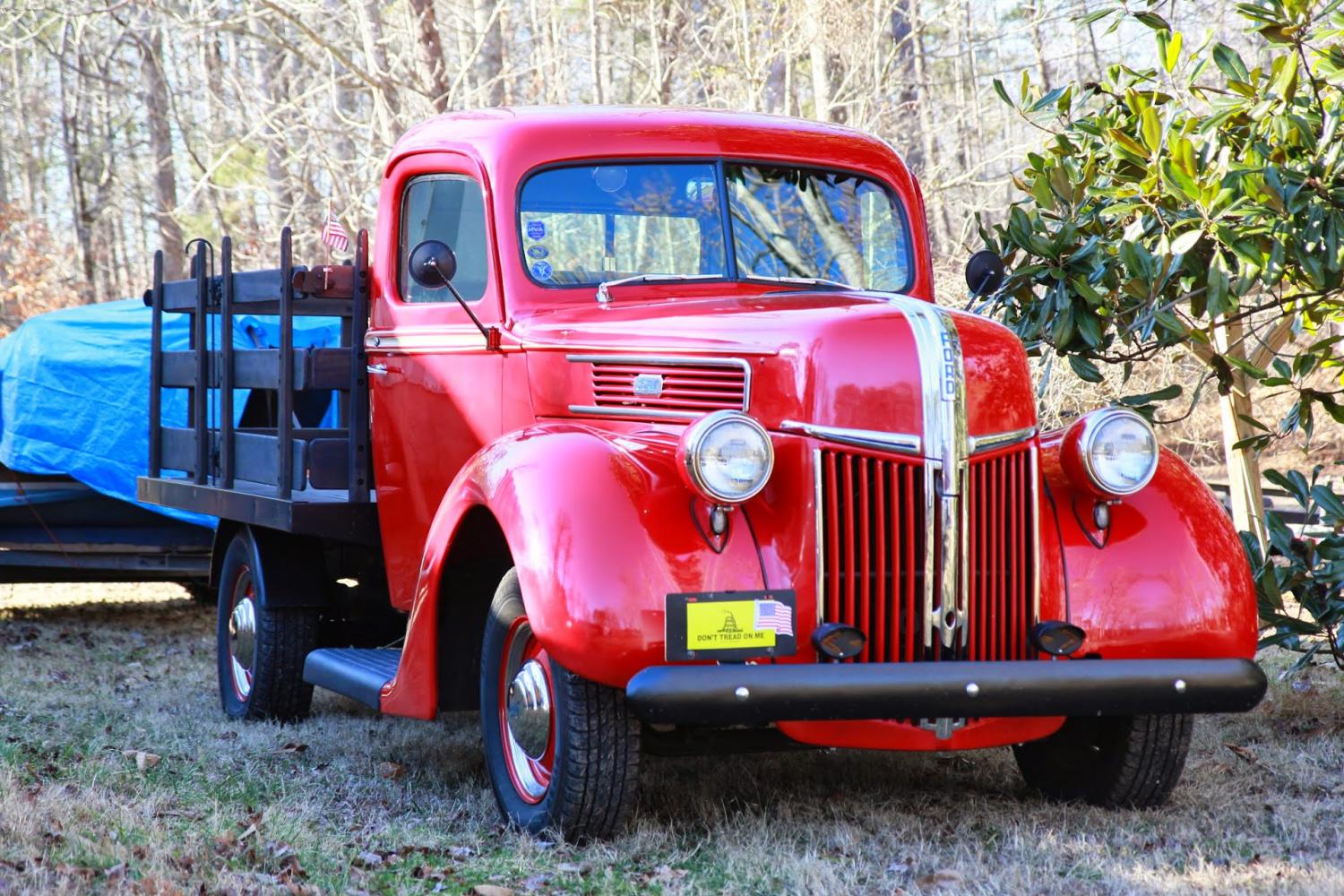

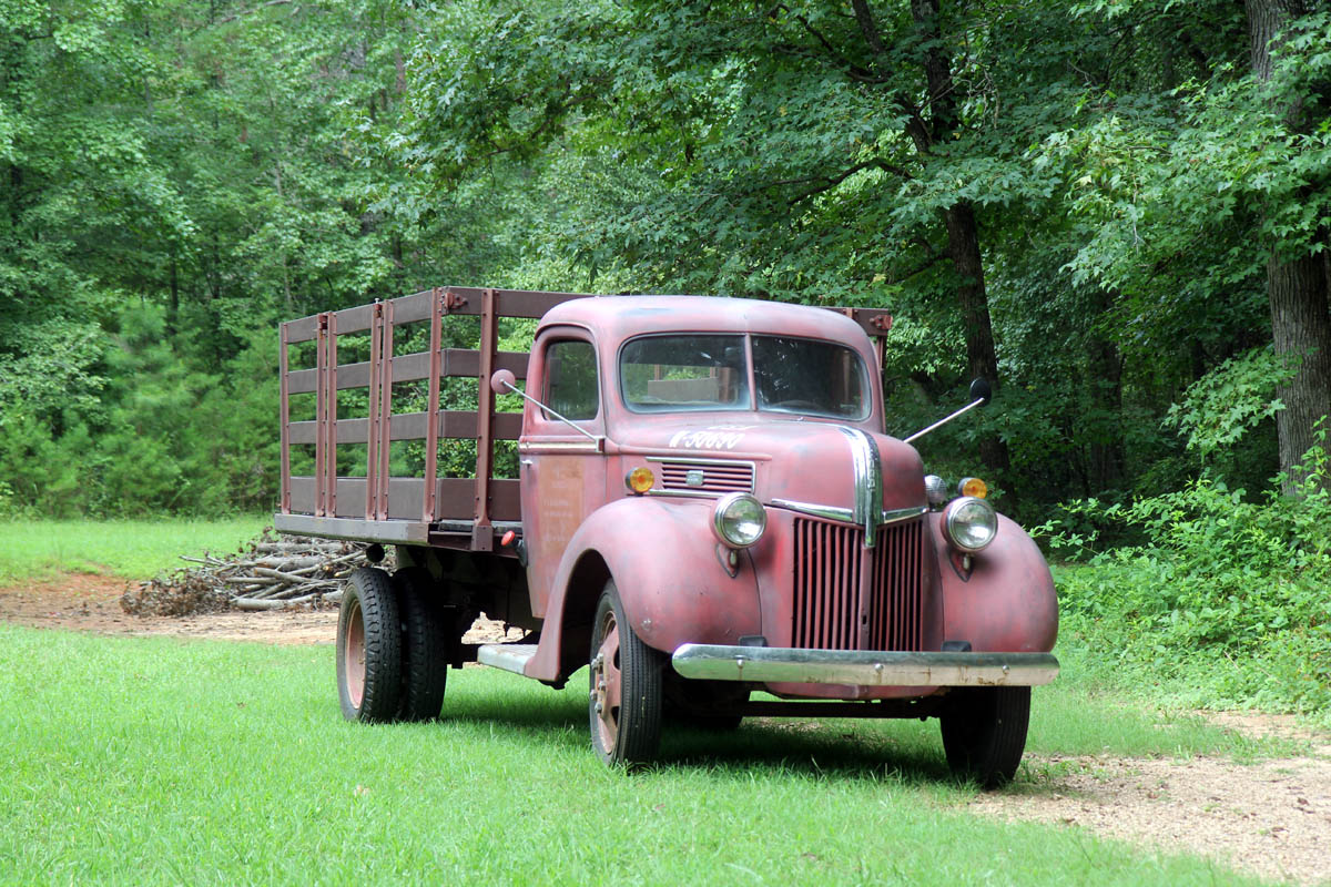

Sorry I've been absent the past few months, things are a little on the crazy are around here (nnnooooo?) since we'll be moving again soon. More on that later, but in the meantime with the 507 coming along, I needed some mechanical dirtiness since I'm fresh out of projects. Enter that flathead from that 52 Ford I bought as a donor truck to the Flames to Fantastic 52 Ford I redid for my buddy!
