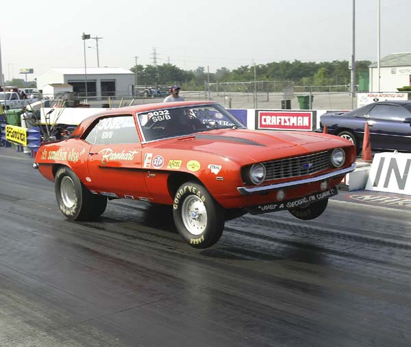

Here's an original paint car for reference blackout position with respect to rocker spear and end point.

Good picture. That's what I was trying to explain to my painter yesterday...Joe

Rs zl1 # 55

Would love to see more of that car!

Love the gloss blackout!😂

Does the rocker spear angle up or does the paint tape line angle down on the ZL1 drivers fender?
