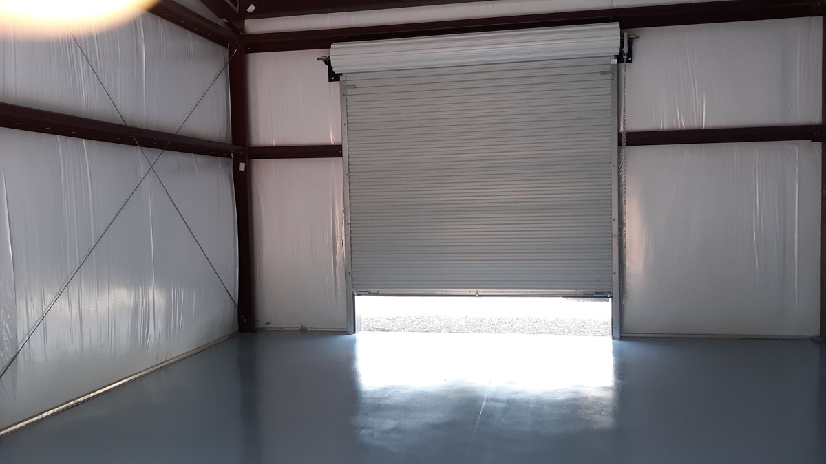

I am building a new garage, and was of the mindset to put down a good epoxy that will resist solvents etc. A nice commercial grade material, but a buddy suggested that I just polish the floor. I thought about and considered this may be a good option. I know this is used in offices in some applications but did not know if anyone has used in their shop. Anyone have any experience with this?

For what it’s worth I dyed my concrete , rough trowel, sealed then epoxy. Another section I used race deck.
My concrete is a bit dark but overall I’m happy
