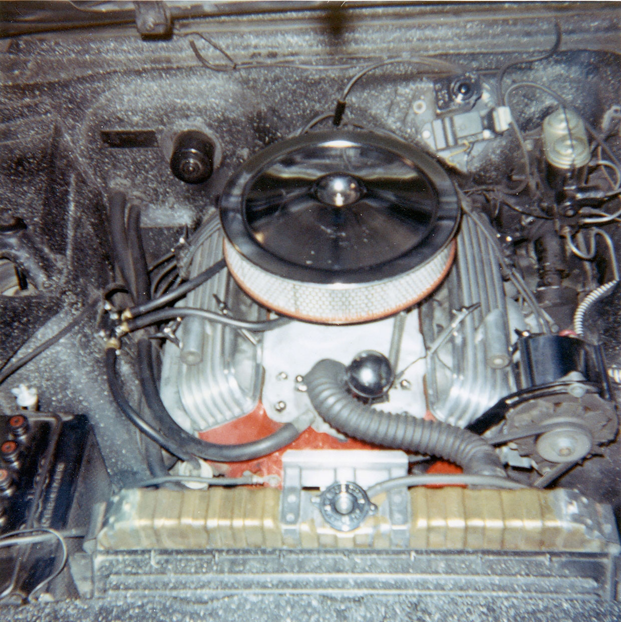

Can you help me out? I'm not super familiar with vintage speed equipment. I'm hoping you can help identify the mods on this engine bay by brand / model and the type of wheels the was running in both versions.
I have two different versions>
Engine: Mod 1 and Mod 2....Mod 1 I'm calling the orange intake with chrome valve covers and Mod 2 I'm calling the silver intake with finned valve covers.
Wheels: What wheels with white walls and what wheels with slicks and jacked up front end?
Helping me identify the parts will help in my search to recreate some day.
Last question...how fast would this setup have been against some of the quicker cars of the day? Legend is he put 4.56 gears in and it was a stoplight warrior.

Stock height, looks like Torque thrust 2's for rims. They both have aftermarket manifolds, it looks like. Factory L79 chrome valve covers on the first pick. Neat car...does your dad still have it or you even?

Those are not white walls, they have blue stripes. Probably Good Year.
I've got a pair of 6 hole 8 1/2 inch slots like those. They are market Universal Wheel USA on the back.

I've never seen valve cover vents like that before.
The intake manifold in the first picture looks like a L79 intake that has been painted orange.

Possibly Cal Custom aftermarket finned aluminum valve covers.
