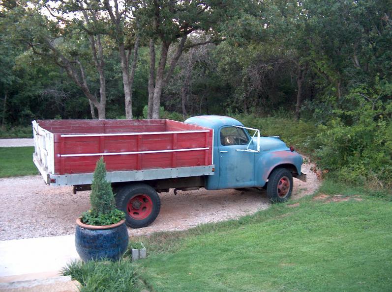

Yes, Ryan, you remember correctly. I have a 49 Studebaker Dump truck with a chevy engine and trans. It is very small for a dump truck,. no longer than a late 90's F150 extended cab short bed. Lots of fun.
