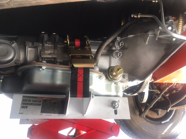

So picked up this 57k orig mile impala ss 396 car and decide to build a factory sleeper here are some pics of the build I finished this car in 5 weeks and drive it weekly hope you guys like

Replaced orig numbers 400 trans with a mild built one and a custom billet convertor along with a new driveshaft. The factory 12 bolt had a eaton posi with 2.73 gears so I installed a Yukon posi with a 3.55 gear set.
