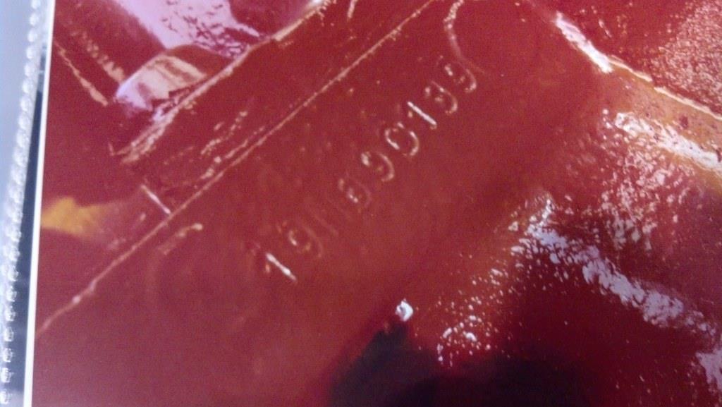

Any thoughts or known history on this car as to authenticity and REAL #'s matching? Have never seen a deluxe interior car without a console. With two big options like L89 and JL8 I want to be sure before I consider this car. All comments are very much appreciated.

With nothing more than beauty shots little if anything can be determined from the photos... call a competent person to look it and the ORIGINAL paperwork over with a fine tooth comb.

124379N690139
Nice, but all the docs are fake. JL8 wasn't available by then.
Haven't seen a tag pic.

" Its impressive factory documentation includes the Protect-O-Plate, broadcast sheet, invoice sheet, window sticker, delivery check list and owner's manual."
I would call that fraud if all the docs are fake.
Unlike most of the fake docs, this one has a real person and a real address. Most seem to be non-existent addresses that cannot be traced.
Coounty records of the property here: http://www.pcpao.org/?pg=http://www....33699481003105
Kenneth Wright did live at the address on the docs, or at least he owned it. He died in 2009, and case was probated. So, it is possible that he was the original owner of the car and that the current owner purchased it from the estate.

I figured it was the same one with all the fake docs that was in Florida however without concrete proof I didn't want to tarnish someone else's car. I thought the auctions were trying to police themselves a little better. Then again I guess that is why none of the fake docs are shown on the auction sites.
I have customers who call me with this car and that car asking if it is real, so much time is wasted messing with a bunch of crap that is so wrong I laugh when I actually take a look at them. It irritates me that people want you to spend time and money to come look at fake docs in person when I could eliminate the vehicle from my clients scope by merely seeing the docs. Then again some people would rather have an incorrect aged window sticker than to admit they don't have one. [img]<<GRAEMLIN_URL>>/rolleyes.gif[/img]
