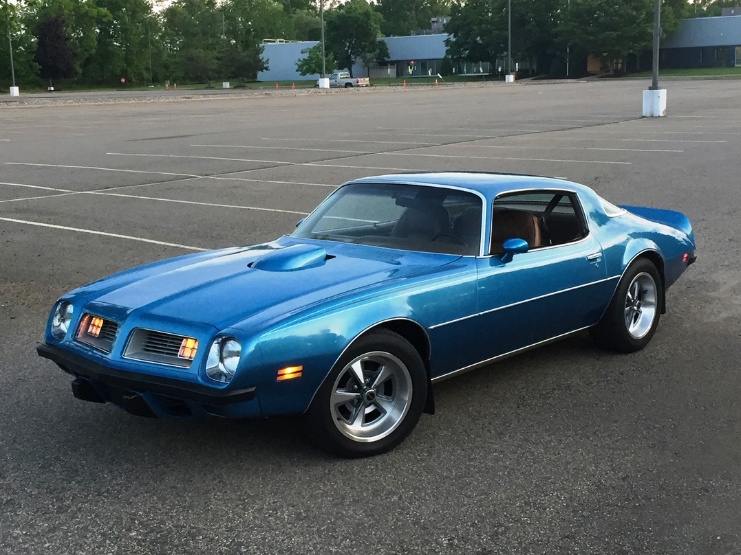

It's been slow around here so we decided to do a little engine work on the 1975 Firebird that my grandmother bought new from Ruckles Pontiac in Yonkers, New York back in September 1975. My grandfather traded in a 1969 Thunderbird plus cash for the Firebird and drove it off the lot. Gramma Rose drove the car for several years and then ended up giving us the car in the early 1980's when the door just got way too heavy to pull shut. (Anyone with a second gen F-body will know exactly what I mean).
We got the car with 38,000 miles and my brother drove it for a few years til it ran up 70,000 miles. At that point it just sat around and I ended up taking it and repainting the car and giving it back to my father as a gift. He proceeded to park it in the garage and throw all sorts of things on top of it and drag garden hoses across it. So I reposessed it in 2004 and brought it back to my house.
Anyway, Since my daughter helped rebuild the engine in the 72 T/A back when she was 8, I figured it was time to let my son try his hand.

Steve is that a Formula, or was there a hood swap?

It was an Esprit and I added the ram air hood and the correct ram air air cleaner back when I painted it in 1994.
