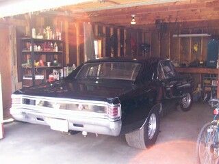

I need a strong differential for my '55. I like the Strange 60 only because I have always thought Danas looked cool. Any advice on either company or type of rears?
