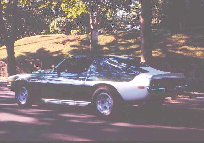

When Motion added sidepipes to the Camaro was the part of choice from the 67 Corvette?
I think they did probably up till 69. Then in 70 I recall seeing mostly the Hooker Header type.
1969 Z28 1972 Corvette |
the 67 Corvette side pipe was used on some 70s and maybe later. The Hookers were used also. This was probably left as an option to the customer
Do they make a header/sidepipe combo for a 68 Camaro BB? I've never seen one.
-----So did O.K.Kustom out of Michigan. OK actually did headers and sidepipes for sale thru GM dealerships with GM part #s. I bought two or three sets for Corvettes that way. They were more performance oriented than the Hookers I think. I believe OK also made Camaro undercar headers for Camaro small-blocks with GM part #s on them. I dont know, however if they made Camaro header-sidepipes....Bill S
