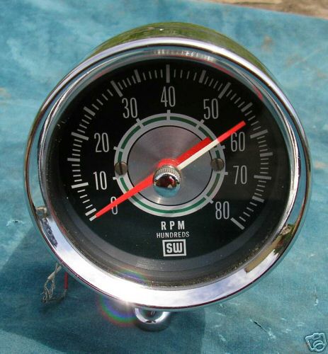

Well I sent out my SW tach to be repaired about two months ago...and just got it back. Note inside said unable to repair!! I am pretty sure now that this tach uses a sender and does not directly hook up to the coil. ANyone have any experience with these? Here is a pic of the tach. Thanks

I sent my SW tach to redline gauges. They converted it to newer technology. They actually utilize the sending unit as well, and it requires that you hook it up as original. I have their # at work and will post it tomorrow.

Yes it takes a sender...maybe Tachman should look at it ...do you have the sender ? www.tachman.com

nope, no sender...yet!!..sent it to Bob's speedometer and they said they cant take it apart so they wont try and fix it...any sources for senders??. I'll call the tachman tomorrow. Thanks for the replies.

Mine was converted to sender-less operation by the Tachman (I think; it's been a while).
Thats what I'm hoping!!!. Thanks
