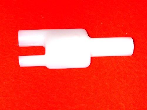

Does this look anything like the original, this is a repop from Ground Up?

Yes,that is almost Identical to mine here. I'll send you a jpeg via email. Rick |
Looks pretty decent. Other than being nice and white looks like a original
Thanks guys, it's actually not that white, I edited the pic to brighten it up. Any ideas on where I can get a restrictor for on the top?
Any ideas on where I can get a restrictor for on the top? [/ QUOTE ] I used a axle tube vent still available from GM. Fits right into the top of the surge vent. Allows venting and keeps dirt out. ![]()

Actually, The restrictor for the top is nothing more than a piece of foam...similar to lawn mower filter material. A friend found a NOS one years ago...thats all it was foam...about 3/8" x 1/2". I put a piece in mine, and have had NO problems in 2 years...no leak, no fumes, no fuel tank collapse...Just my experience

I really wonder if all the 69 Chevelles got them
My previous Chevelle did not have one, but I chalked it up to the fact that it had the fuel tank replaced. Now the black Chevelle I have doesn't have one either, and it is untouched. The 2 vent hoses end so close to the floor pan that there would have been no room for it, so it's not like it might have fallen off or something. I have no problem with fuel spillage or leaking or anything, so I'm leaving well enough alone.

I have two originals here that I took off of cars in the 80's.They are yellowed,but useable.They used to have a foam element inside,with a cap on it as well.
