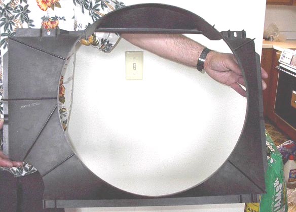

Looking for rad shroud for 70 camaro I think it's a 6cyl one?? Does anybody know if the 6cyl is different then the V8 one?? Thanks Kim PS pictures would help [img]/ubbthreads/images/graemlins/dunno.gif[/img]

Kim, I cant provide any info on 70-7? Camaro 6 cyl shroud, but curious what youre working on with 6cyl???. FYI the small block shrouds were made in two designs and are both TWO-PIECE units. The 70-72 Big Block shroud is a ONE piece design, and in my opinion is one of the most RARE 2nd Gen Camaro parts to find, NOS or in excellent used...Chuck S

1970-72 Camaro with 400 or 402 engine 4bbl one peice Fan Shroud Part#3973920.
307 & 350 engines were two peice,but I am not sure about 6Cyl.shroud design.

Here is the answer to your question. 6 Cyl in '70 came standard with a "cap" (Half shroud) which attached to the Radiator cover plate which is located atop the core support. This is where the factory emmissions decals were placed.
But there is also an exception... If a 6 cylinder was equipped with option V0-1 HD Cooling, (AC) then the small type standard small block V8 shroud was installed.
No AC gets the 6 cyl the CAP. AC gets the 6 cyl the shroud.
