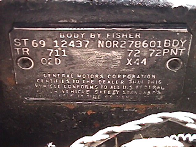

Here is the pic of my firewall data plate off a rough 69 Camaro RS Z-28 that I bought and need to know more about? Not sure if it is a real Z or not but you guys on here are more knowledgable than I am.
The block is not correct for the car all the numbers I can find on it are it is a 350 with the numbers = "12R517370" then a "T" and a "IL". About all I know it was a Orange car. Console gages, 4 sp. 4:10 12 Bolt, RS grill. Thanks in advance for any help you can give. Pantera

The trim tag does not designate your car as a Z28. What is the Vin of your car?

X44 is base coupe with no style trim group and not a Z28/RS. A RS z28 would be a x33 code..

Yup, it's not an RS and it's not a Z28. Does it have PDB and a cowl hood? What's the axle code on the rear end? What transmission does it have? The 02D date and NOR 278601 number is a pretty wide spread. Makes me wonder if there is something unique about the car.

Definitely not a Z/28; it would have X77 or X33, and not X44. Sounds like a base coupe. I don't believe it's even an RS.

Well I wondered if it was anything good? I guess not. it does have the cowl hood and the other goodies. Of course all of them could have been put on it. I guess I misunderstood that the X was a special car. It does not have the big block heater outlet so I am not sure if it is anything other than just a plain camaro with options. The front end has a RS new grill and the headlights are cobbled in on some kind of strap that didn't come from Chev. There is no place for the lights to mount. I did pick up a set of RS lights at a swap meet for $100 and was planing on using them on this car.

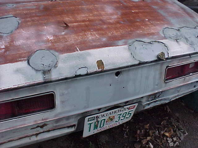

one more of the rear where a emblem was--- note the two holes are not parallell

Looks like non-RS tailights too!

The non-parallel holes are the standard holes that every tail panel emblem used... Bowtie, RS, SS, and Z/28 emblems all used the same holes. Thats also why Yenko used the staggered positioning of the "427" and "Yenko" emblems on the rear... to utilize the 2 existing staggered holes left when the bowtie emblem was removed.
