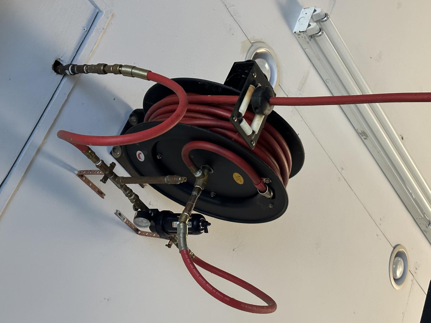

Hi everyone. Looking for advice on the best air piping to use for garage compressed air system. I would like to conceal in the walls and above the ceiling for the installation method. What is everyone using?
