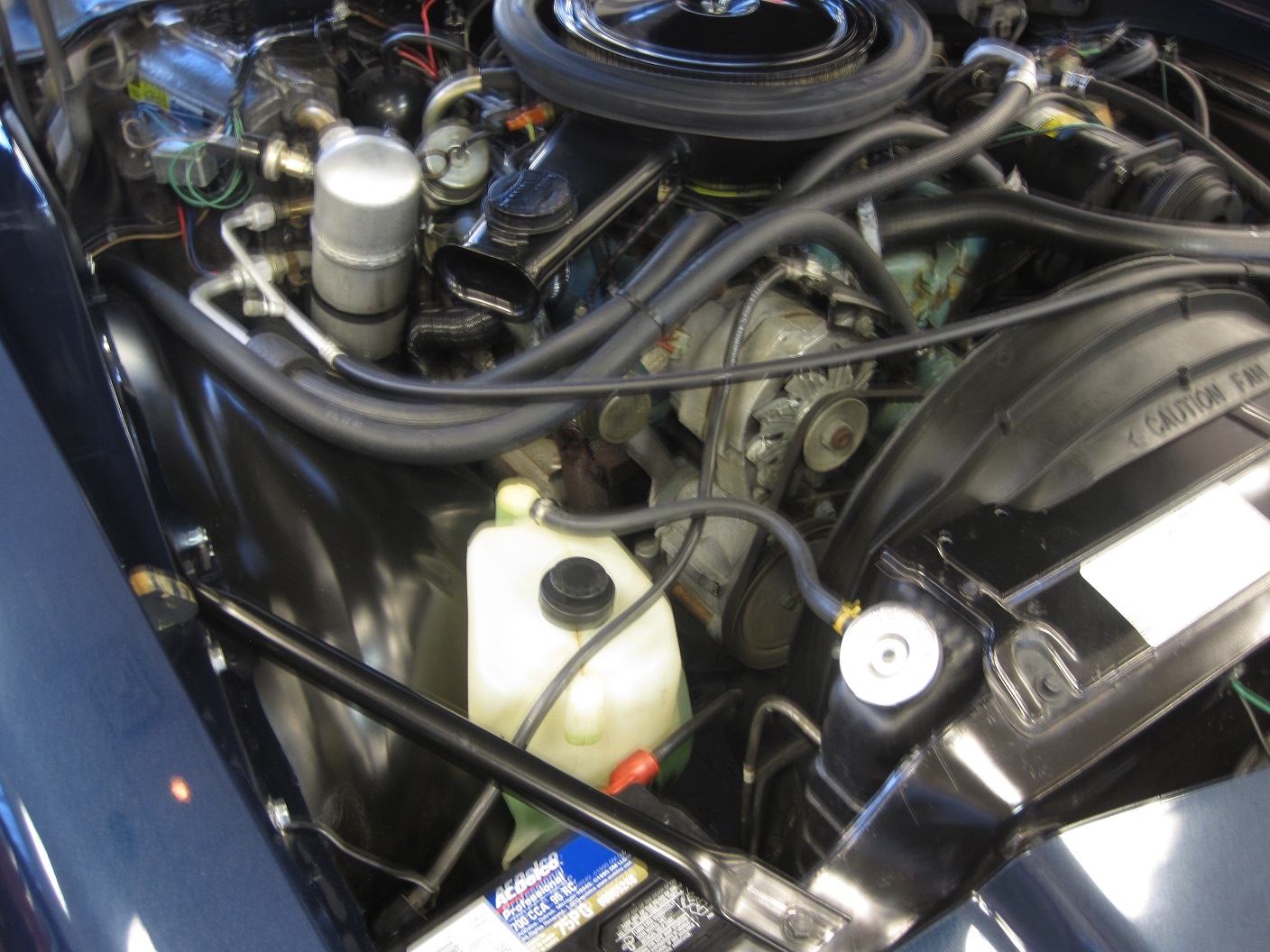

Andy, here's a photo from 2016 Camaro Nats of an unrestored 9k original mile 1980 Z28 inner fender...hope this helps. Not super glossy...IMO closer to 60-70% gloss.
Thank you Steve, and yes this does help!
