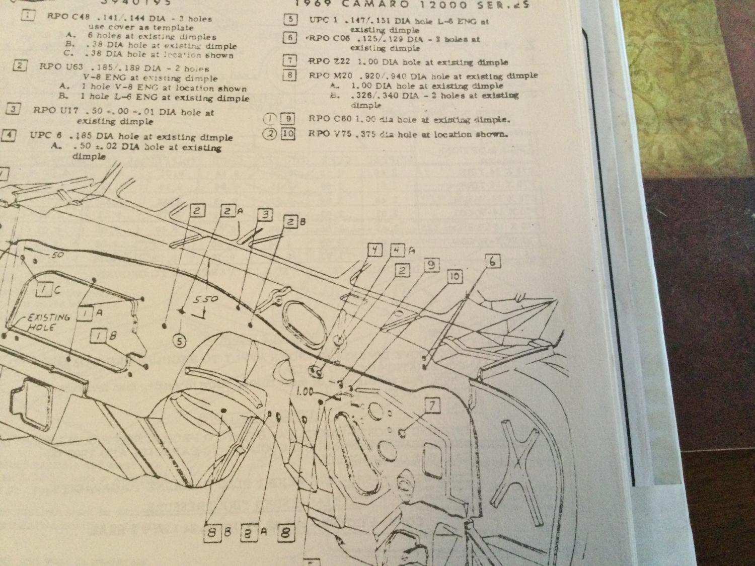

I am looking at an 1969 Camaro RS/SS. It’s not totally original by any means. As far as the hide away headlight components. What are some signs I can look for to determine if this car is possibly an original RS. The current owner stated the door don’t operate unless it’s done manually. The rear valance does have the back up lights but haven’t confirmed it to be original. The car has had the quarters replaced.. it is a LOS car.

I’ve added RS package to a few 69’s over the years. Anyone can splice or cut very nice holes for RS backup lights. The vaccuum canisters etc with correct holes thru inner fenders are quick check. The hardest part is the hose routing with the hole in the firewall and all of the hose routings to the correct RS headlight switch and headlight washers, etc. If it has the correct RS hoses through the firewall etc. it sounds like it is either original RS or it may not matter if it was converted correctly.

The bad thing about the VanNuys cars is they didn’t get the big trim tags like the Norwood cars did with the X codes…If it’s original check the piercing on the firewall for the vacuum lines going to the headlight switch … I am not 100% sure if all Rally Sports had the headlight washers .. Try & find some original RS cars & check where the reverse light wire goes threw the trunk floor… Also if it’s originally an RS it will have style trim, wheel opening moldings, roof rail moldings & the gills..

The vacuum canister is definitely missing and didn't see any of the related hoses. I will try and get a closer look at the firewall. Thanks for all the information.
