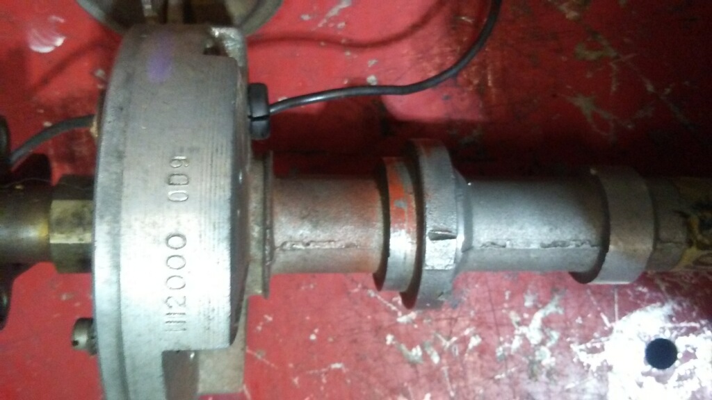

What cam goes with the 1112000 ? On a quick look in the search section, I've seen 724, 728, & 732. Mine has a 730. It's a 0C18. A little help please. Thank you, Joe

Heres one i have with 732.
Just curios Joe, does your dist. have the original vacuam advance still attached to it if so are the stampings ms 355 15. thanks Marc.
The vacuum advance has been changed. I was going to advertise it for sale but I need to know if the parts that are there are correct or not. Since I've come up with 4 different cams, I don't know what should be there. Thank you, Joe

732.
