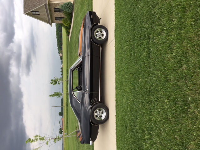

Here's the look on my 1969 Camaro. These are a borrowed set....I liked the look so bought a pair. FWIW my front springs are not stock.
