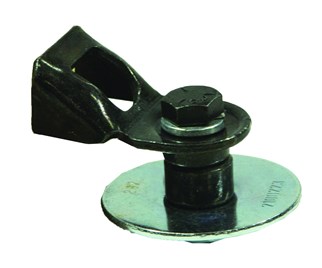

I've used these before to install into the package tray, simple through-bolt anchor point with a plate washer below, for a top-tether child seat.
It does require a discrete hole to be drilled, and I used a cheap reproduction package tray panel to avoid piercing an original, but small price to pay to help the kids travel safer.
